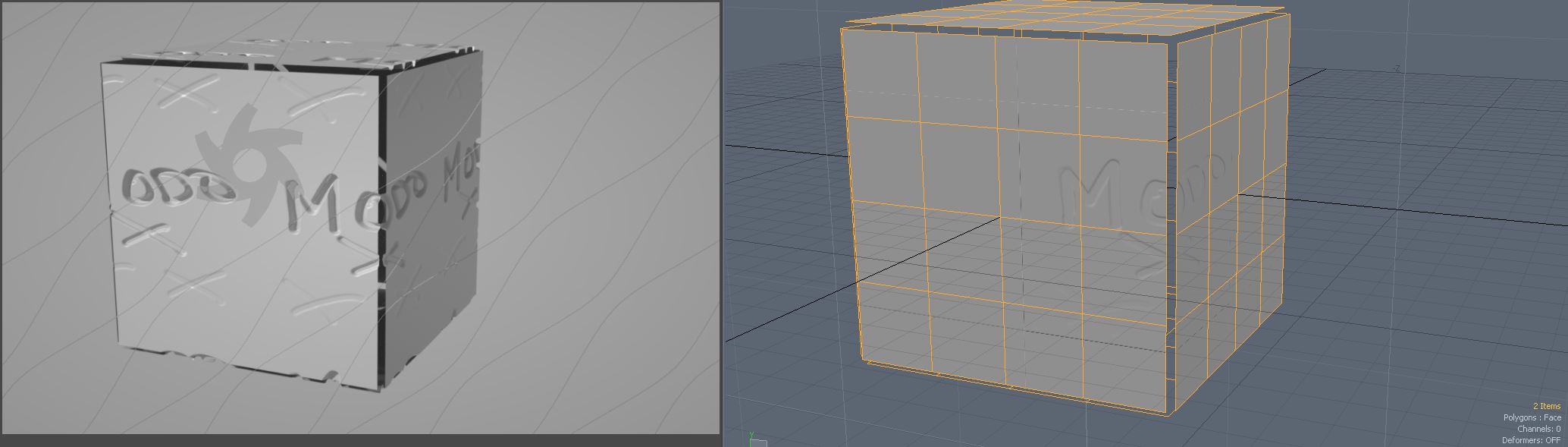

Hi, trying to learn to use disp in modo I cant fix this, the disp is repeated around the mesh but the "repeat" atribute is in "reset" mode, but octane is ignorint it..
how to fix this? (its a simple cube mesh with the default uv map)
thanks

As per the Displacement notes in my forum signature, the Border Mode is ignored for Octane Displacements, so the textures will always repeat. I'm not sure if the demo version supports this or not, but if you are running Modo SP3, you can turn on the Render Cache (Preferences->Octane), and the micro-displacement polygons will be used by Octane as geometry. This can be slow, but gets around the Octane displacement limitation.
