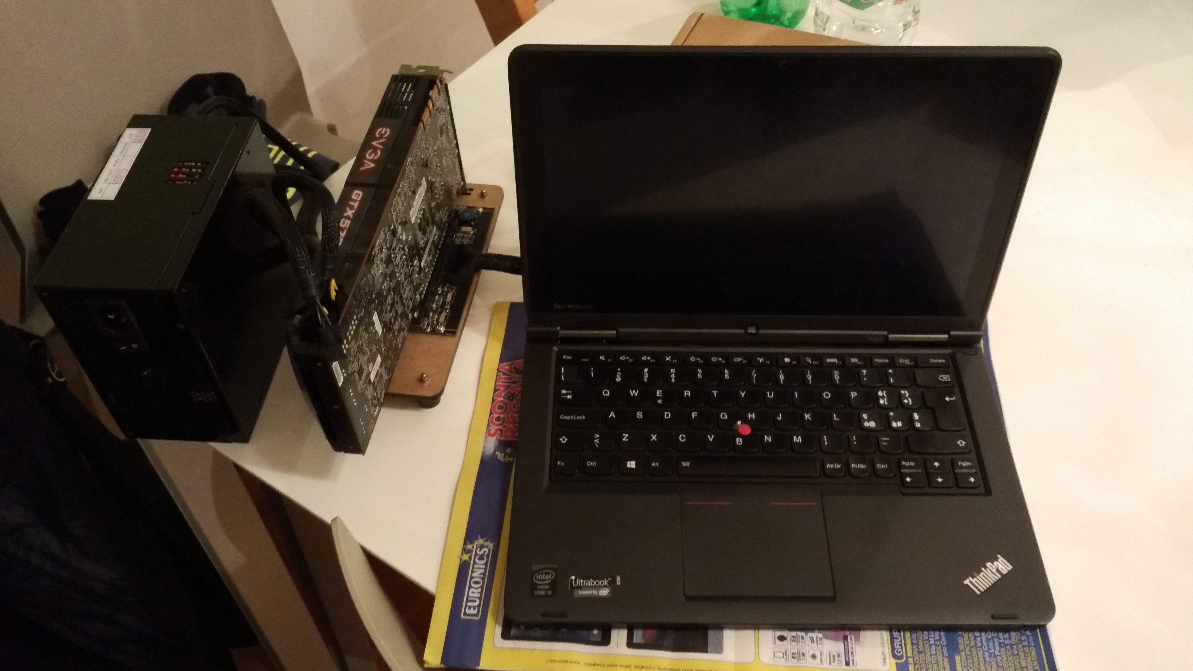

[Hi, i want to ask information to you :
Please see the image.... Why my vga when i power on the atx power supply is broken?
I see a little fire on vga and smoke....
What i wrong?
What i wrong?
SORRY, MY ENGLISH IS BAD!
2 Xeon quad core E5440_8gb Ram_Nvidia GeForce 2GTX 780ti 3Gb/Nvidia Quadro K2000_Win10 64bit_Octane 3.02_Rhinoceros3D
I use Lenovo Thinkpad W541 with a cluster from Amfeltec, If your laptop has an express card slot, you can buy a cluster that has a connection option for express card. so you can use 4x GPUs inside your laptop
3x GTX Titan - Win7 Pro x64 - Intel i7-3930K - ASUS Rampage IV Formula-X79
maybe the powder is the faulth...
I tried with another VGA, all right, is not burnt!
The big problem is another:
I connected the PCIe extender (mpcie to pci x16), module slot wifi, I turned on the notebook, but unfortunately the PC is left with a black screen and the "Fn" key with the light on ...
i don t have any chance to connect a external vga? (usb3, hdmi,m.2 internal slot)
Bye
Bye

I, i solved the problem of black screen.
Now the vga is detect but a new problem is arrive... I can use it because an error encorred.... Error 12..what is and how can solve it?...
Please help me!!
Please help me!!

error 12? where, when, how..talk a bit more in order for us to help You.
