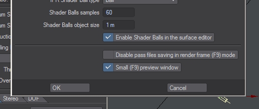

Can you please test this new custom build? It has a new options in the plugin options panel to reduce the size of the preview window, so now it switches to a lower size after reach less resolution. With this option enabled, you should be able to have always the full preview window in you 1600x900 monitor.

That fixed it. Thank you very much!
