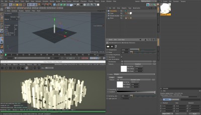

I tried to scatter simple objects with an emission mat on them.
The "cast illumination" option seems to not work with scattering.
Any hints or will this be a future feature?
Thank you.
Posts: 10611

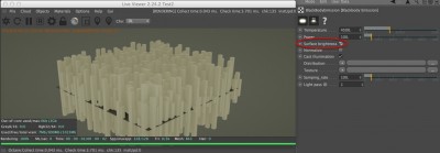

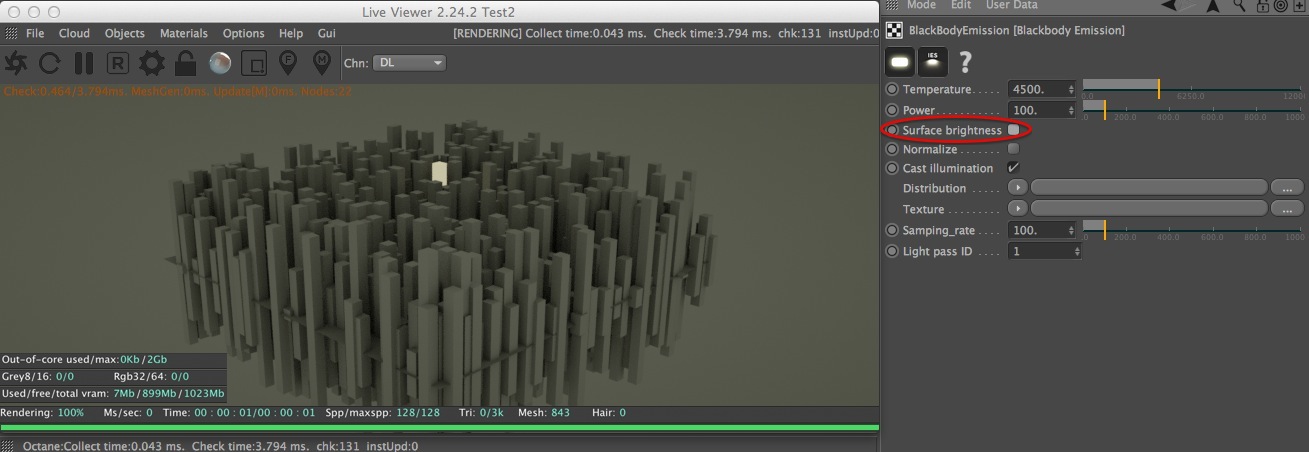

You have to enable the "surface brightness"option in the blackbody or texture emission node:

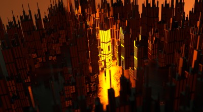

You can even have random different emissions for the clones:
