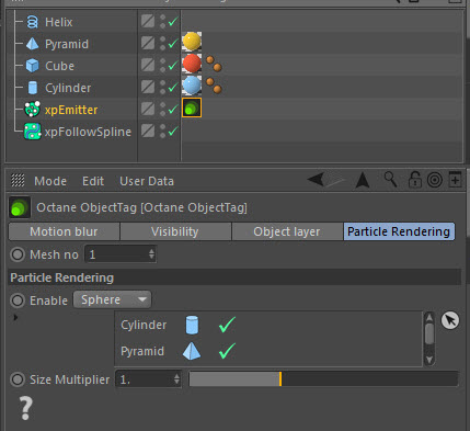

fatfreemedia wrote:Thanks - this update is great. Is there any way to shade the particles via Octane or is that in a future release?
You can use custom objects via object tag. I'll remove "particle engine" option from LV menus. Thanks.
