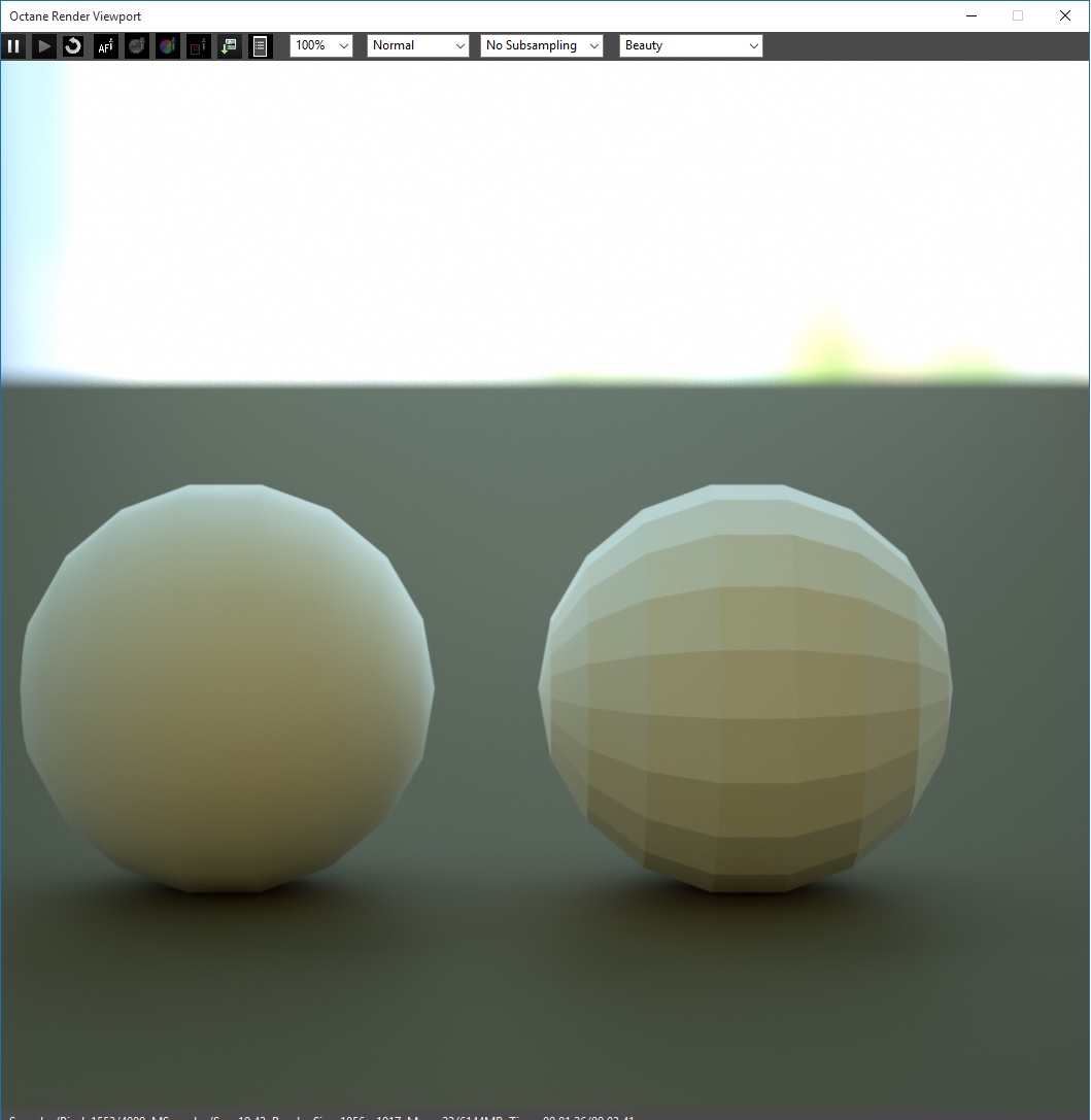

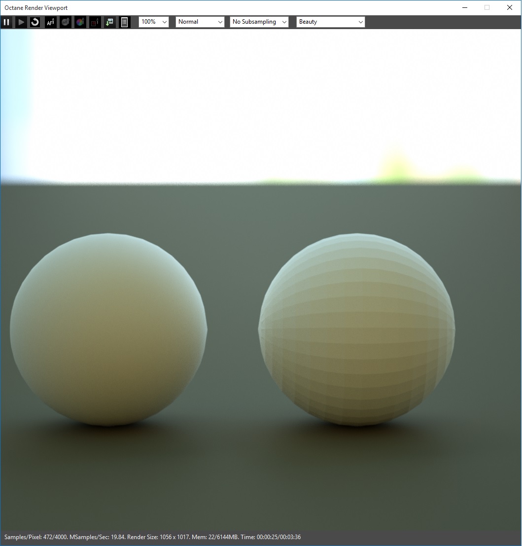

Smooth does work with enabling smooth in each material
It does not do it as good as Poser, but in Octane you can turn on subdivision and it will look better
See attached pictures
Without subd
With subd
