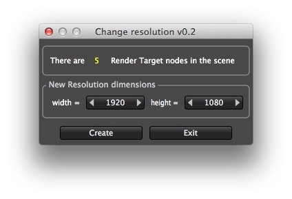

Posts: 10626
Hi kavorka,
changing the batch rendering script is a nightmare for me, too complex for my skill :)
But I have created a lua script that changes all the render target resolutions in one time:
RTresolutions-02.lua
(5.45 KiB) Downloaded 913 times
could it be a good alternative solution for you?
ciao beppe
kavorka
Posts: 1351
Joined: Sat Feb 04, 2012 6:40 am
Yep!!
Still would be nice in the batch script but this is awesome!!!
