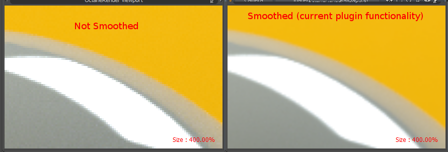

Could you please add function which change pixels interpolation from blurred to sharpen.
This works then zooming rendered image to 200 and much persent.
Hi Dmitry - the Qt API has the ability to zoom the viewport blurred and sharp. I've attached a comparison. IMO the blurred version looks better. Is there a reason you want sharp?

+1 for not smoothed.
Don't know why it should be blurry.
3ds Max plugin is also sharp.
Photoshop showing the real deal too...

I think best way to find compromise blur or sharp make option with blur and sharp options. User can choose which one is good for him.
In some situations sharp interpolations show better undarstanding samples problem.
It's better representation (in large zoom about 200%) problem sampling.
