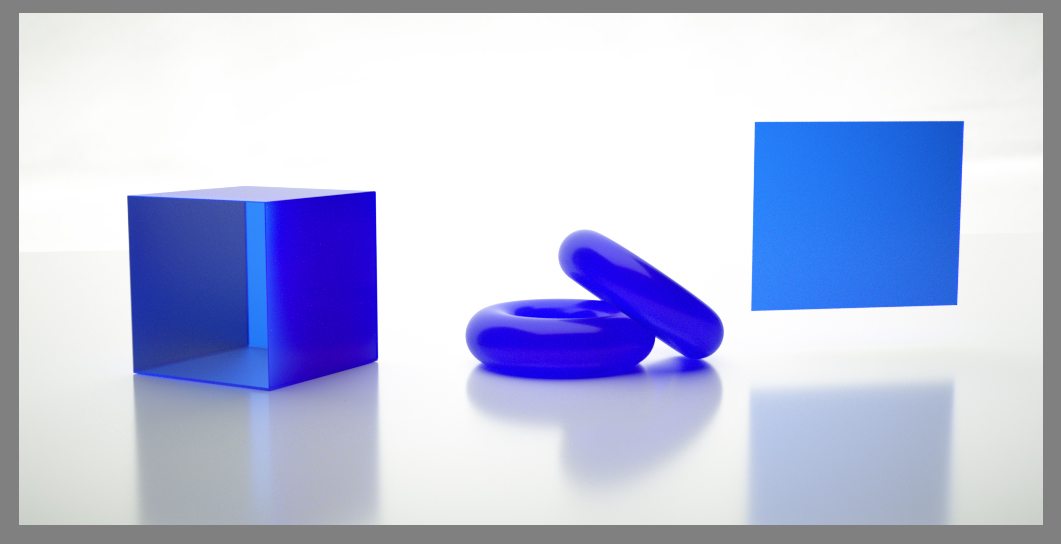

Made a quick example so you can check it out realtime
It`s OR 2.23.2
sss.orbx
(6.19 MiB) Downloaded 170 times
