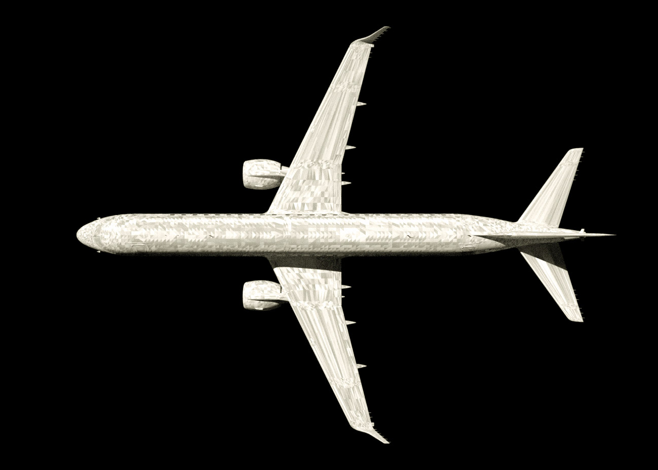

New Cinema 4d user here with Octane plugin so sorry if this is a known thing but I'm not sure what to look for. Anyway, I downloaded a model from Turbosquid in C4d format and when I try to render it in Octane I get the attached weird artefacts. Anybody know what's causing this and how to fix it? I've applied a new octane material but that didn't fix it.

probably a scale issue!
try adjusting the rayepsilon in the kernel settings or chagning your scene size in c4d

ray epsilon. It's very similar parameter like that "view clipping" in C4D.whersmy wrote:probably a scale issue!
Np, welcome here. As Whersmy said, there is a relationship between objects/scene size and ray epsilon. Octane works on float-point math not double. This parameter helps when FP math is not enough.rojharris wrote:Fantastic! Fixed it.
