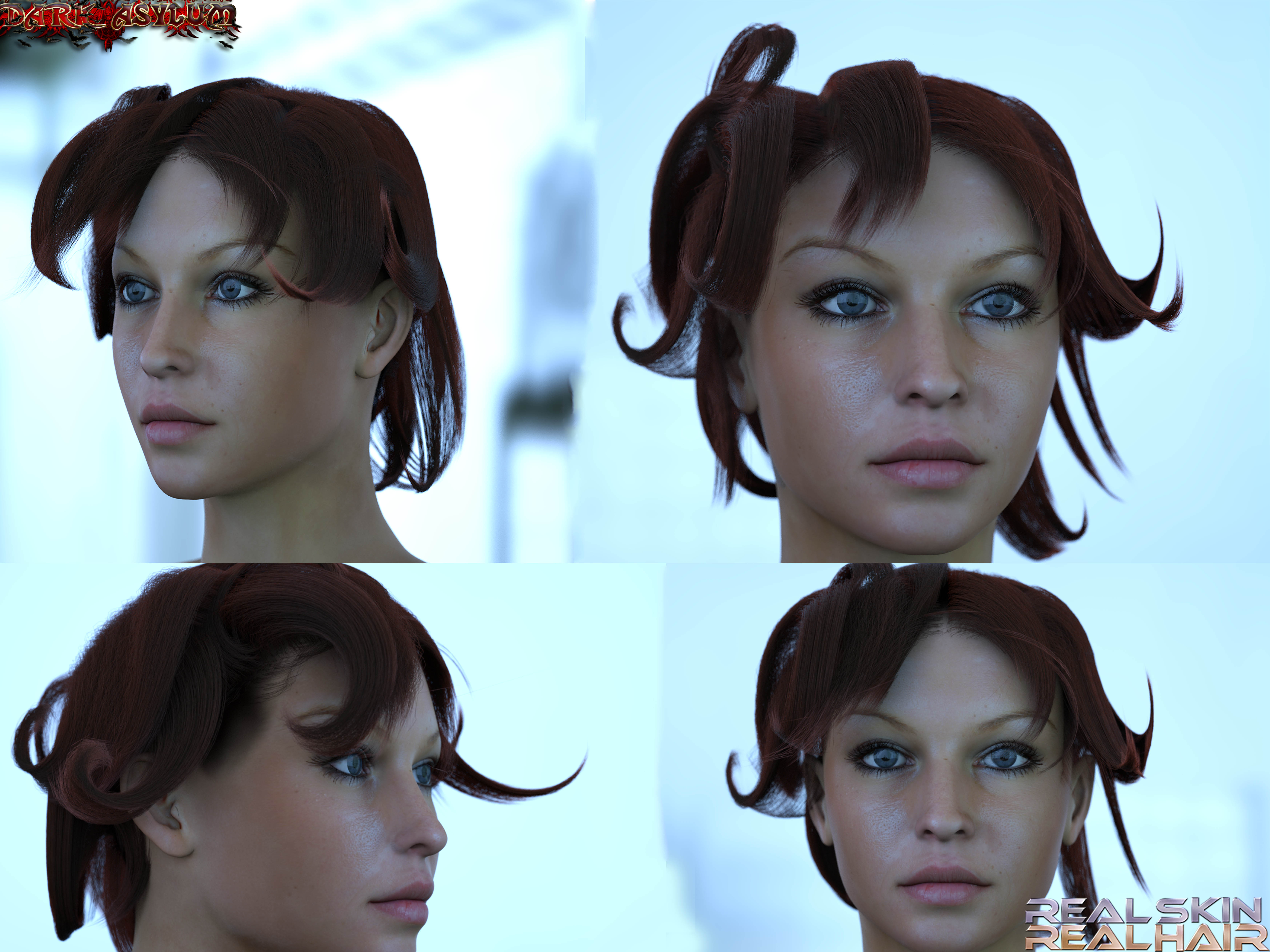

it not so much that you need HDRI more that you need, SSS skin shader. there are free ones in the live database. (under skin) that you can use.
google HDRI free samples. lots out there you can download without spending anything
The below pictures are my own skin shader and my own hair shader. That will be available to buy very soon.
