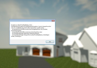

And getting attached error message/may give a clue I don't know.

Hi Geof
What is the release number of the OctaneRender for Revit plugin you are using pls? And which version of Revit?
That error means that Revit was in "edit" mode (ie. when you are adding a wall, before you click the Modify button to accept the wall) - and when in this mode no plugin can be run. Ideally you should not have the plugin setup window open when editing your Revit scene - however 99.9% of the time the plugin should handle this OK. For some reason in your case this is not working correctly. I haven't had any other reports of this - so will be interested to know the version you are running.

The exception being returned from Revit indicates you are - it is saying there is a transaction currently open (transaction = unfinished edit).No I wasn't Edit mode.
