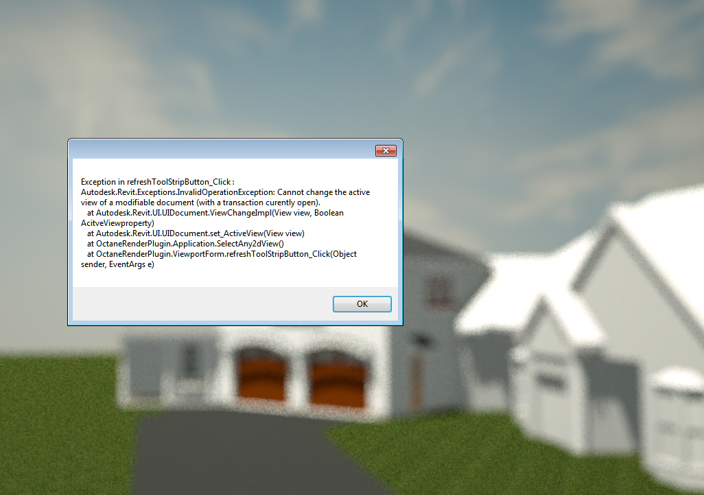

Hi Paul,
Octane is adding the model from (other) Stand-Alone project into my (different project) Revit Octane Viewport. The model itself is not related to the current Revit file I have open. The camera was out of focus, maybe trying to figure out which model to look at or maybe getting info from two scenes? Also, when I export to OCS and open in Octane Stand-Alone, only the (other) Stand-Alone project opens (and it's not the one I most recent Stand-Alone project I worked on). Also (I think but I may be doing something wrong) it seems to be preventing me from successfully changing a Revit RPC tree into an .OBJ proxy.
And getting attached error message/may give a clue I don't know.
btw, Paul, THANK YOU for clueing me in on that export to OCS option - it is totally fantastic.
Is there some Octane memory buffer or something not clearing maybe?
Geof

Hi Geof
What is the release number of the OctaneRender for Revit plugin you are using pls? And which version of Revit?
That error means that Revit was in "edit" mode (ie. when you are adding a wall, before you click the Modify button to accept the wall) - and when in this mode no plugin can be run. Ideally you should not have the plugin setup window open when editing your Revit scene - however 99.9% of the time the plugin should handle this OK. For some reason in your case this is not working correctly. I haven't had any other reports of this - so will be interested to know the version you are running.

Thanks Geof
No I wasn't Edit mode.
The exception being returned from Revit indicates you are - it is saying there is a transaction currently open (transaction = unfinished edit).
You have (potentially unknowingly) added an ORBX or OCS file as a proxy in your Revit scene. https://docs.otoy.com/#45Geometry%20Pro ... Instancing
