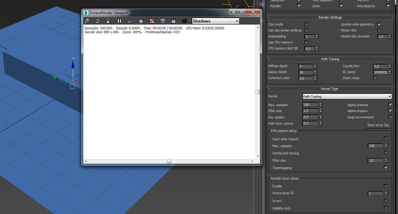

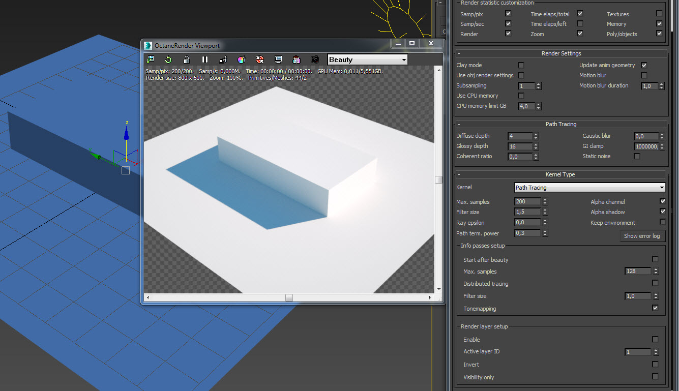

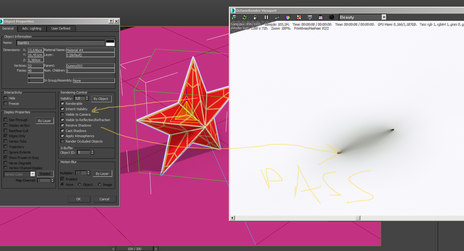

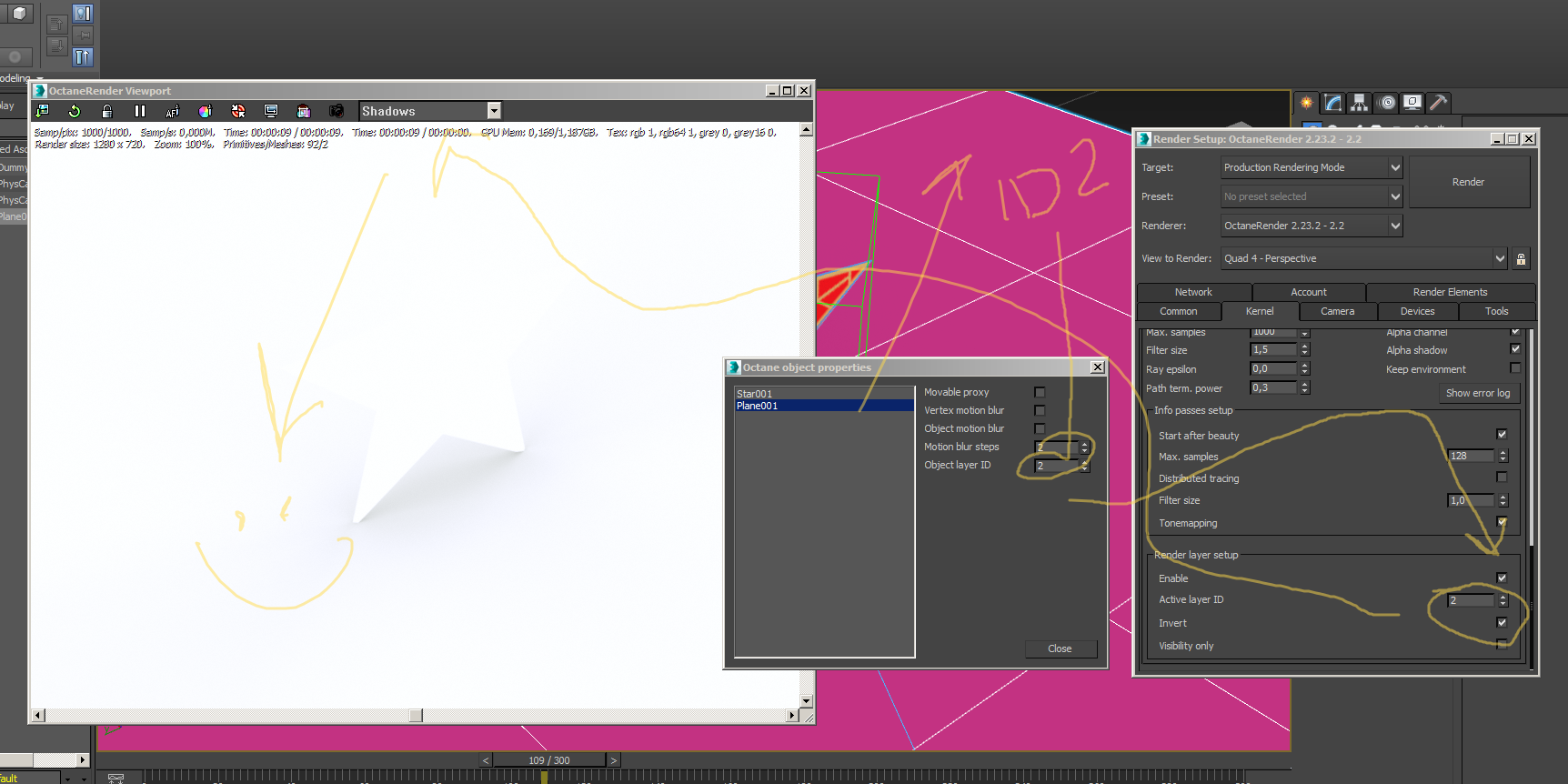

How can i get pass Shadows? I have white image when select Shadows chanel in octane viewport.
Shadow chanel
Shadow chanel
Beauty chanel
Beauty chanel
