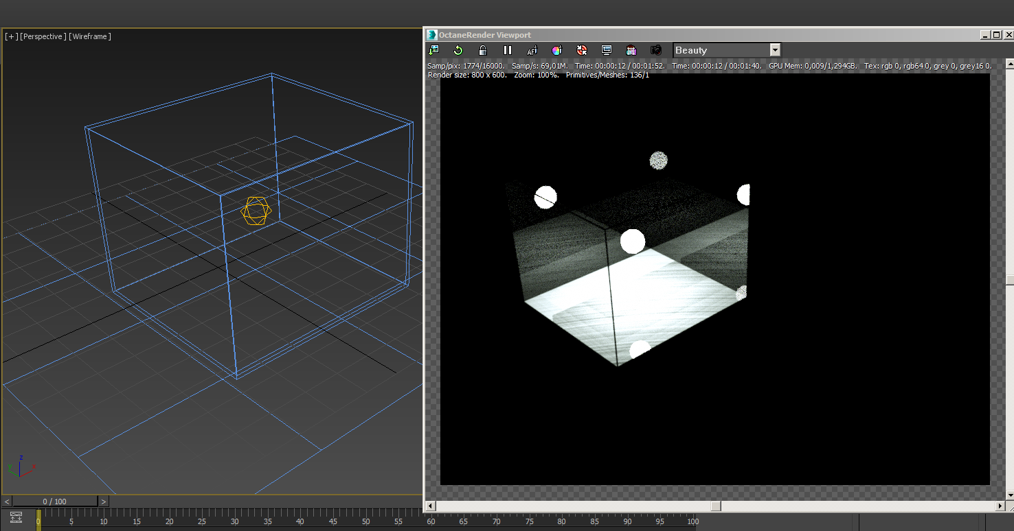

old problems remain
test 2014.zip
(30.54 KiB) Downloaded 357 times

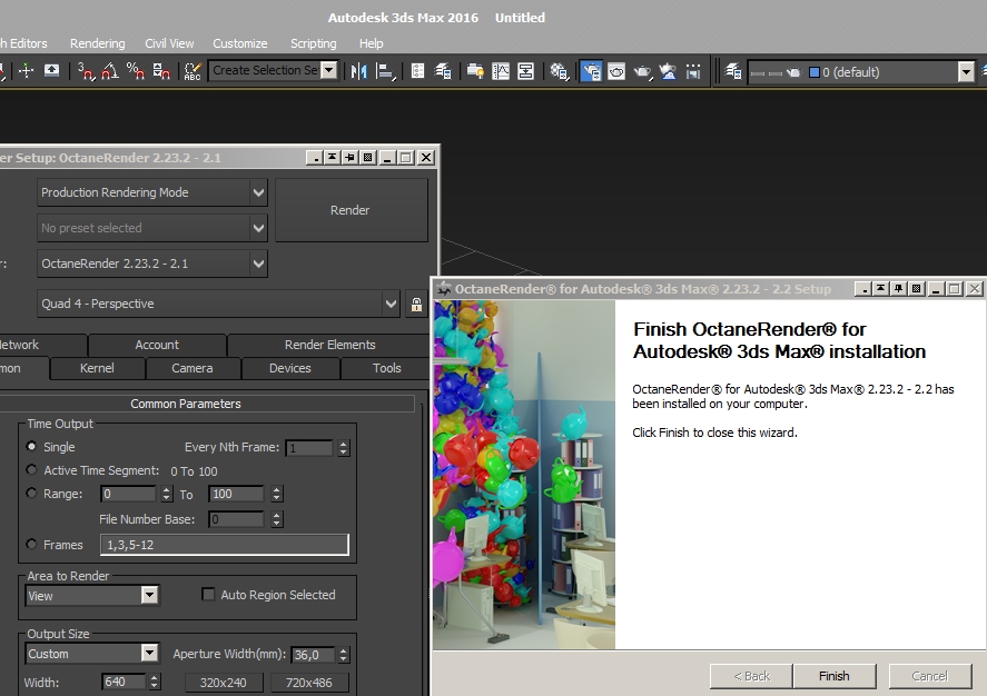

I can not install on 3DS Max 2016. installer again broken?
current version 2.23.2 - 2.2. this installer for 3DS Max 2016 installs a version 2.23.2 - 2.1
r9 3900x/64Gb/2070s/2070/win10x64/3dsmax2021
JimStar
Posts: 3852
mikinik
No, there are no problems with installer, it installs 2.2 version. I just forgot to increment the version number itself, thanks for report.
