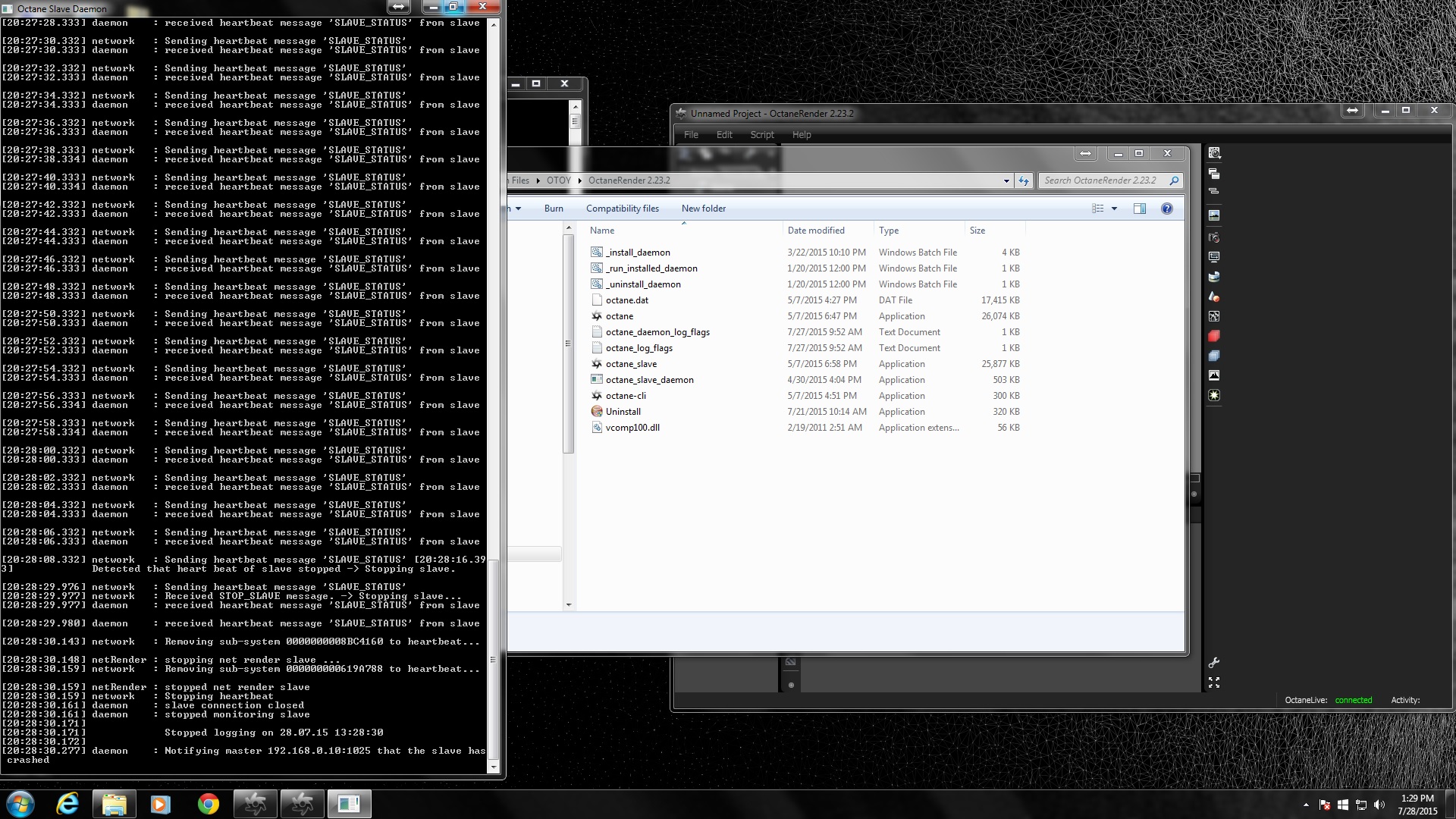

here is an image of the crash

sebastian
Posts: 13
Joined: Tue Jul 21, 2015 11:32 pm
here is the log file
