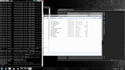

Don't know. I need to see some info. What kind of freeze? There is lot of virtual data on your post, so i can't help. Only thing you can do see client's output when freeze occurs.sebastian wrote:well, my main question is why do you think the network render is freezing? there are no errors it just says it is rendering a sample but c4d is frozen
Also there is not any relationship with XP cache files and Octane freeze. Client could be crashed due some reasons.
here is the log file
- Attachments
- octane_log.txt
- (3.65 KiB) Downloaded 267 times
Windows 7 , TitanX, i5
