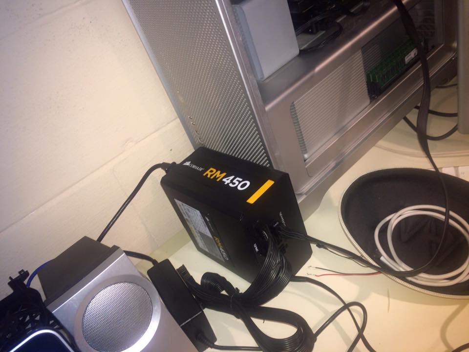

Group,
This is what I have
2014 Macbook Pro
AKiTIO thunder box 2
Corsair RM450
gpu EVGA Geforce GTX 960 SC
Has you see in the images like a glove.
I have read through the thread, could someone direct me to the simplest into getting this running. I am not a hobbiest, I use my Macbook Pro to make a living. I am doing this so when I don't have access to my render slaves I can still do some work and not rely on the nvidia gt 750 in my mac. It is slow for octane and it heats up my mac badly. I would rather heat the shit out of this 250 nvidia card, than my mac pro.
thank you for your input and direction

Perfect...
Do not use the Akitio power supply.
Use:
-Raiser (http://www.ebay.com/itm/271448008328?_t ... rmvSB=true)
Tutorial:
https://www.youtube.com/embed/QfKb8TcHDkI
Works on 10.10.1, 10.10.2, 10.10.3
I have not test 10.10.4 but MarioVisuals did, and I think it works for him.
