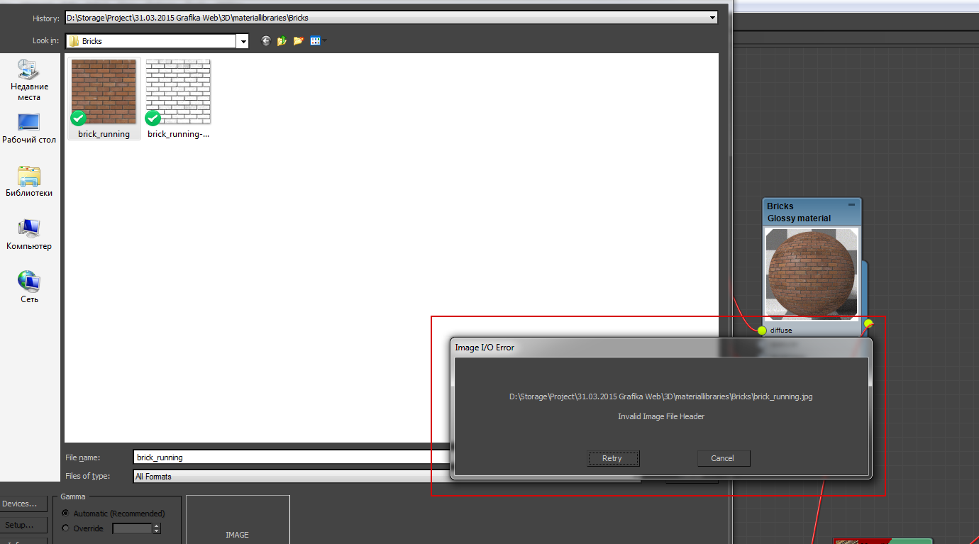

bug

Elvissuperstar007, your file opened in Photoshop parallel. it's 3dsmax problem.
