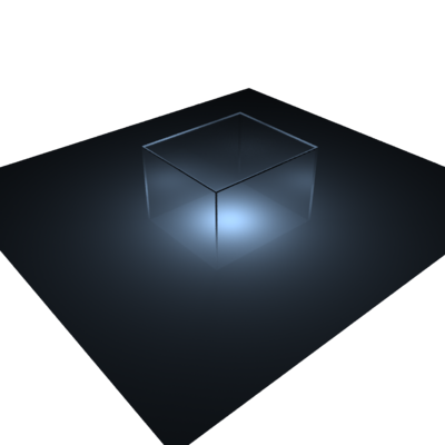

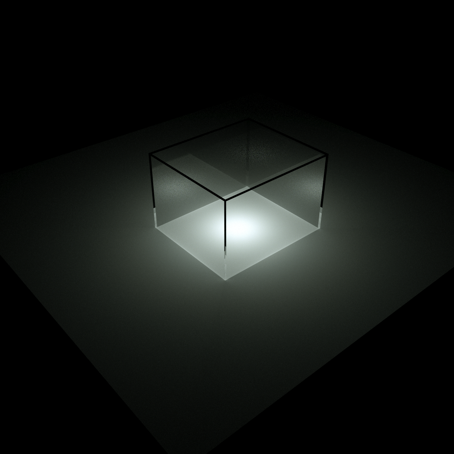

Question to the developers. Very time-consuming and render and virtually no fade white dots inside the glass which reflect the light inside of him. Show two videos
http://youtu.be/bIQzhxSOLn8. - Octan
http://youtu.be/uQ1IpIxfY5A. - Corona ( In Corona render such problem I do not see)
I face this problem for many months . In my scenes a lot of light inside the glass. What I can advise to recommend in the light settings and with?
The only option is to set the value of MAX 12000 SAMPLES and more that leads to a long-time render your scene...
I want to say that octane render 3 video cards: 780 + 780 + 590 Corona render 1 CPU FX - 8320
more blue picture is Corona render : The picture was considered both for 30 seconds
corona2014.zip
(34.42 KiB) Downloaded 207 times
octan 2014.zip
(31.22 KiB) Downloaded 223 times

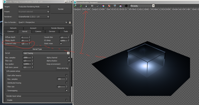

Thanks for the advice. I have made tests and found only here's a quick version. ... To count the light inside turning on Coherent ration to 1.0
But how light will behave inside the interior I haven't tried and I'm afraid this is a bad idea. Interiors with lighting inside glass made in the Corona render- I have a DR render farm. Still use octane simple interiors - exteriors and animation
kevindark
Posts: 5
Joined: Thu May 29, 2014 1:47 pm
I'm glad you resolved the problem. While having Coherent Ratio at max (1.0) is good for still images as your render time will be a bit faster but I wouldn't recommend it for animation. It would cause your video sequence to be flickering if you don't have enough sample passes.
