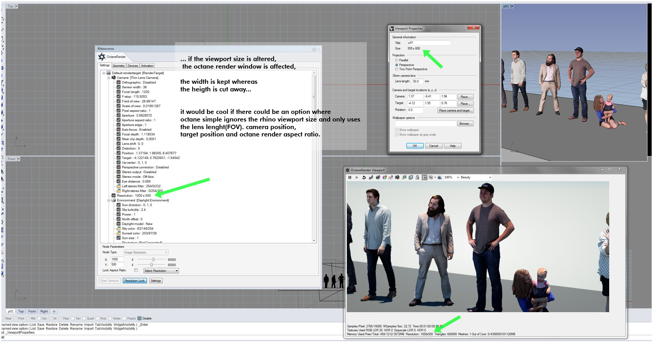

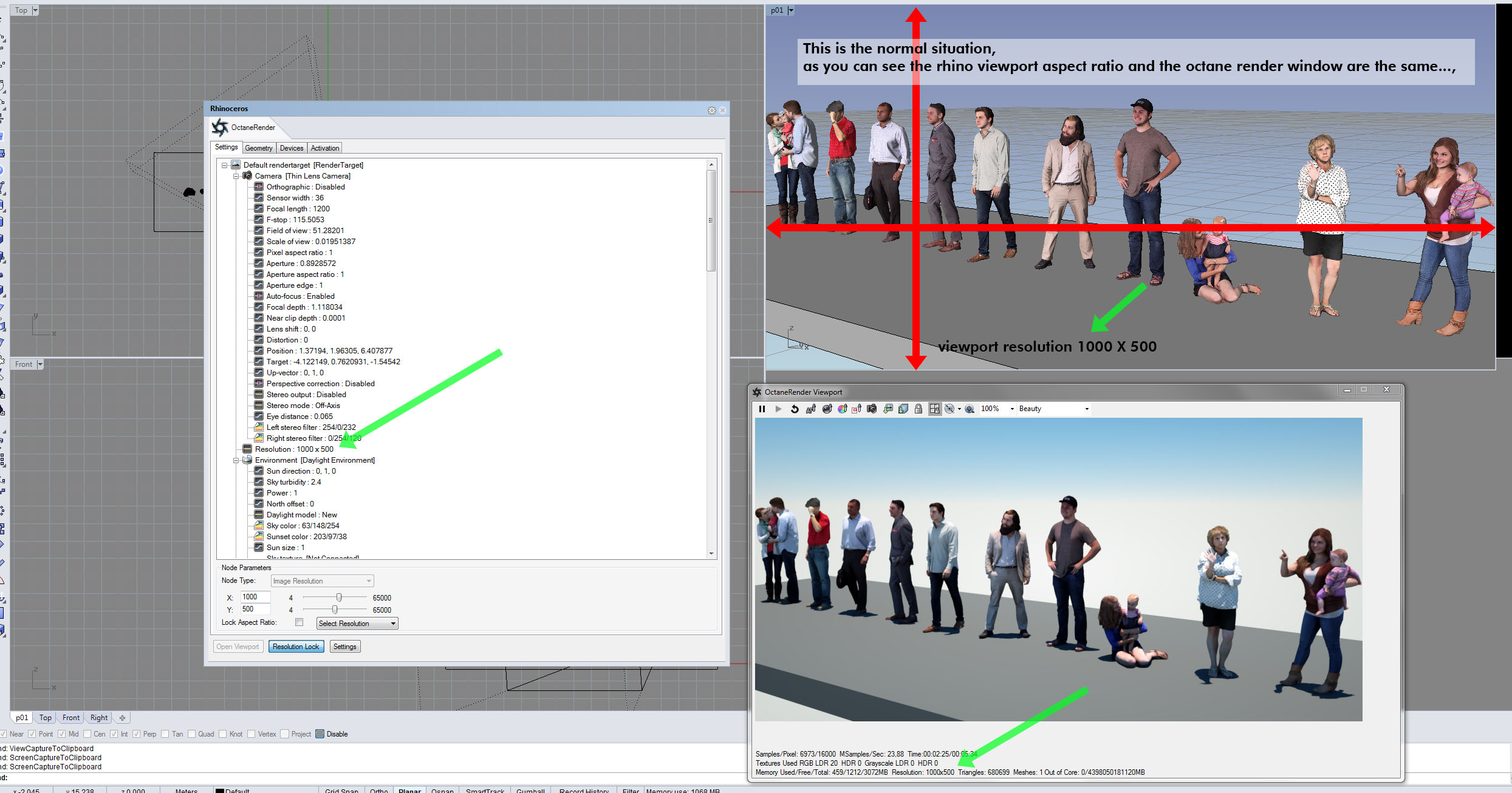

I created two screenshots which should illustrate what I mean... the issue is that unless you specify exactly the rhino viewport size (and therefore aspect size), you will not archive the same render results e.g. on another computer with different toolbar layout or screen resolution.
the only thing which was changed is the rhino viewport size... camera position, camera target, lens length and render resolution are the same.

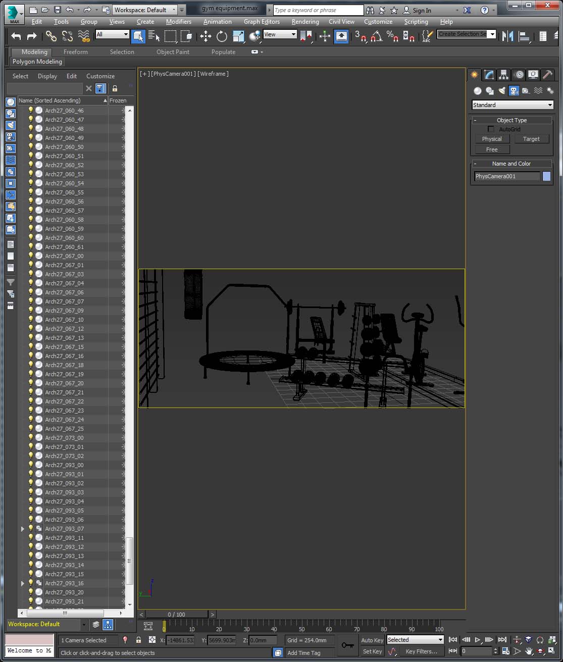

Using the viewport navigation only works if the viewports are set up before each render. If the scene is opened again on a different computer and the viewports aren't the same you can't guarantee the correct render.
What we really need is for the render output to dictate the safe frame within the viewport. MAX does this very well as you can see here. No matter what the viewport size the rendered area stays the same.
Maybe this is more a Rhino problem than Octane?
