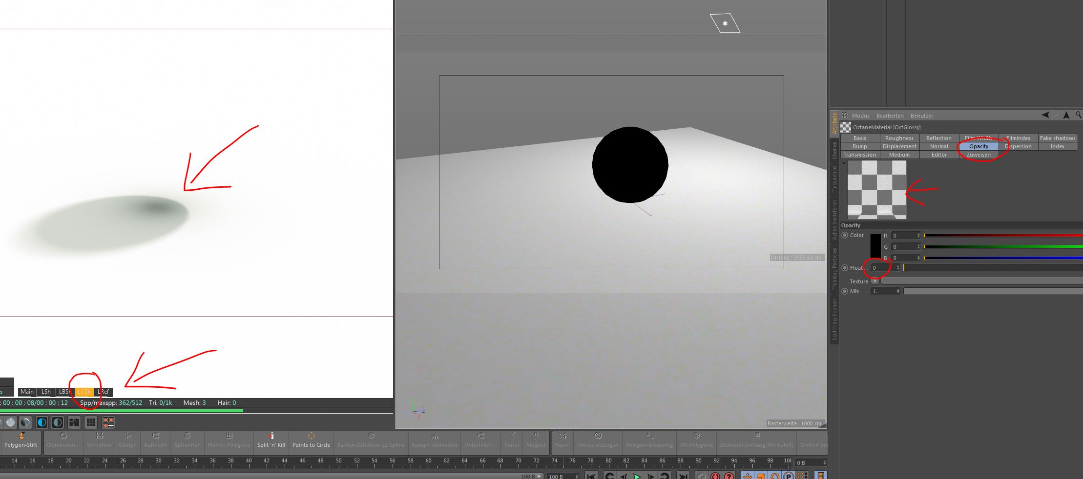

not sure if I'm doing something wrong here, but whats strange is,
when the sphere has a total transparent material (opacity = 0 = unvisible)

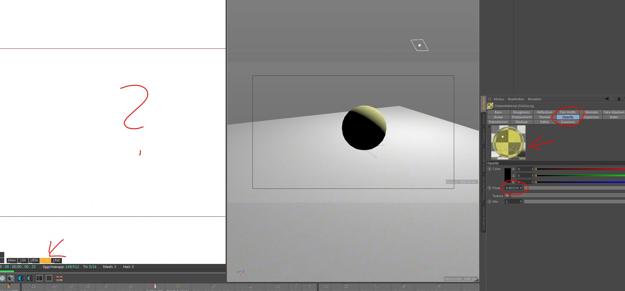

I get the shadows in renderpass. If the material is a colored glass I get no shadows.
Shoul'nd I get normally a yellowish shadow in renderpass "colored shadows"?

Posts: 10619
Try with the camera visibility option disabled instead of reducing the opacity of the material ;)

Hi beppe,
thanks!
Well, acts the same like opacity, but the question is:
why does the object needs to be invisible to cast shadows
and to get these shadows as renderlayer-shadow-pass?
This does not make much sense in my opinion.
