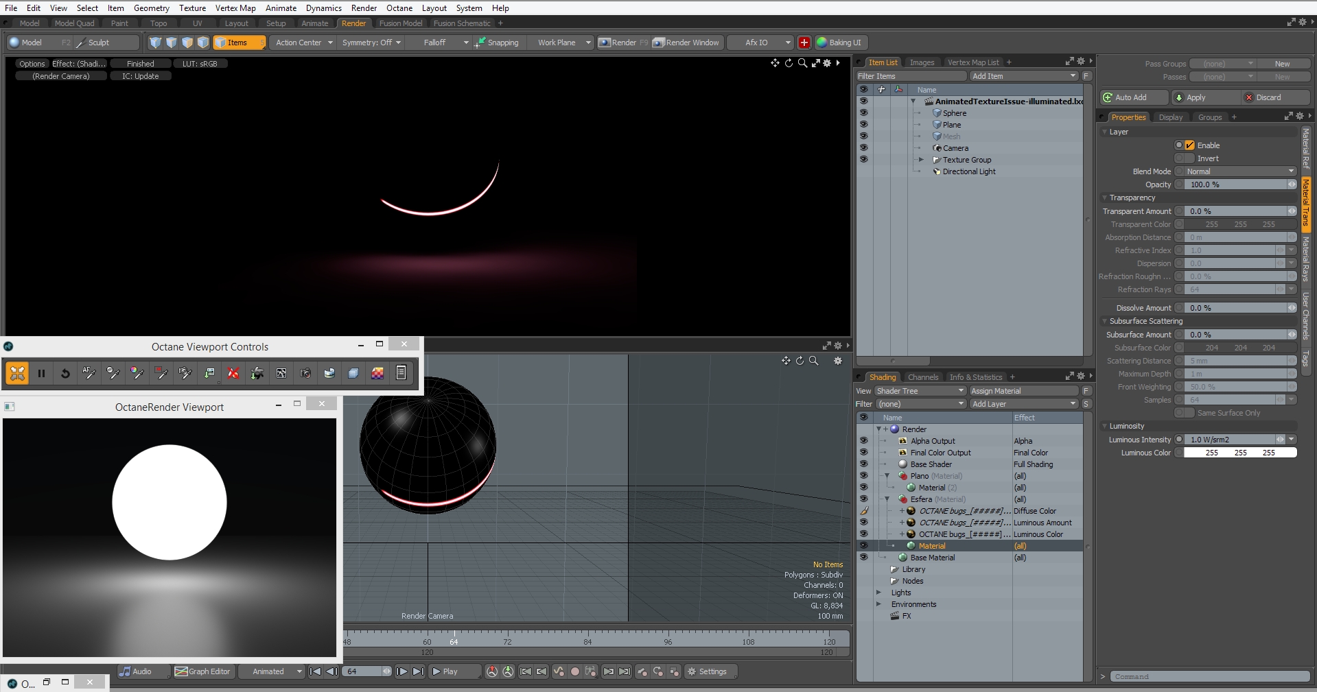

I tried to assign an animated texture as luminous amount and/or luminous colour with no success.
In the plugin, is there a limitation on "luminous colour" and "luminous amount" on the "effect" TAB of the shader tree when doing "on-the-fly" MODO material conversion?
