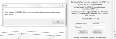

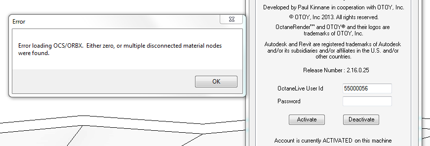

Have been working for a few days in R14 octane 2.16.0.25 and just now I have lost some of my material.
Octane is saying "error loading OCS/ORBX. Either zer or multiple disconnected nodes were found."
20 mins ago all was well.
ANy ideas

bummer
the install has deactivated me from server
now trying to reactivate.......
JNDesign
Posts: 187
Joined: Sat Aug 10, 2013 3:00 am
Hi Paul
It now tells me what maetrial node has been disconnected but doesnt fix the problem
Is the material name given present in your defaults folder (ie. C:\Users\[username]\AppData\Local\OctaneRender for Revit\Defaults)? If so - can you pls send the ORBX file to me?

Thanks - that material is blank/empty. I'm not quite sure how an empty material could be saved by the plugin. Do you recall how that default was saved? (before rendering, after rendering, is it a proxy material default?).
The easy solution is to delete that file and everything should be fine again.
