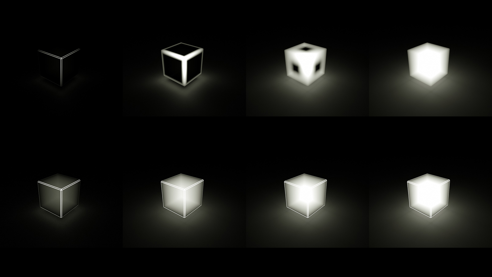

Hope it helps you ;)
Volume_emission_Edge_Inner_and_so_on.zip
(99.22 KiB) Downloaded 909 times
Volume_emission_Edge_Inner_and_so_on.mov
(19.49 MiB) Downloaded 9336 times

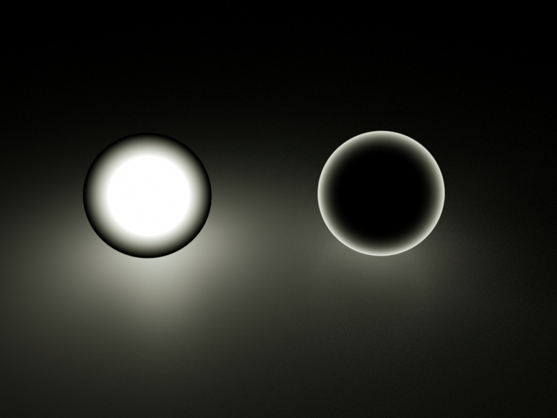

Hey thanks for taking a look at it.
What you've got is certainly a useful technique but it isn't a Fresnel effect.
A Fresnel works by constantly adjusting to where the camera points. So if you have a sphere, the sphere always has what looks like a ring of light around it wherever you look it it.
If I put your material on a sphere I get a load of polygon squares that make up the sphere... cos dirt doesn't work in the same way as a fresnel.
The sphere on the right is what I get with yr material. The sphere on the right is what I'm after (c4d native render shown).
Anyone got the answer? I'm kind of surprised this hasn't been addressed before....

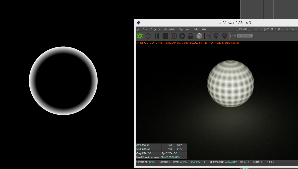

Omg man . Take it :D
Volume_frenel_emission.zip
(117.13 KiB) Downloaded 972 times
Posts: 16068
Location: Türkiye
Or you can use gradient + fresnel. Gradient can change the falloff curve.

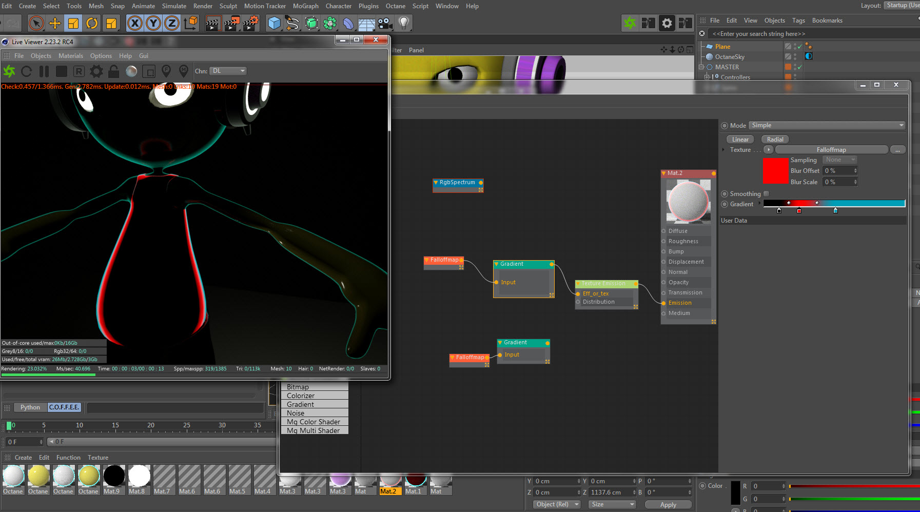

Ok seems I have a bug...
I have no Emission Efficiency option in the Texture Emission shader....
Anyone know what I do here please?
Screen Shot 2015-06-17 at 12.37.01.png (35.73 KiB) Viewed 10484 times
Cheers,
Luke.
Software: Cinema 4D r16, Octane v2.24.2 R1
Hardware: Intel Core i7-5930K CPU 3.50GHz, RAM 32 GB, 3x GeForce GTX 980
Posts: 16068
Location: Türkiye
bleepurchin wrote:Ok seems I have a bug...
Cheers,
Luke.
hi, it has not this pin. so that's not a bug. But i missed to change name to "texture" in nodes.
