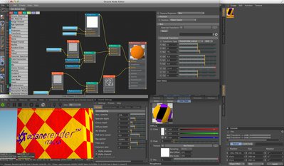

its not working like that. It's easier to implement in cpu renderers. we have mix material and textures and built-in transform node. you can simulate same results by this methods.
Hi bleepurchin,
do you mean something like this? you can use a mix material but you can use also a mix texture node inside a material and you can set different projection per any texture. ciao beppe

Ah I seeeee!
Yes that looks about right... I've not plaid with a node based setup yet... kind of seems to me like it should be possible with less of a setup than that though... ie - two tags one alpha - end of!
well at least its possible!
Cheers!
L.
