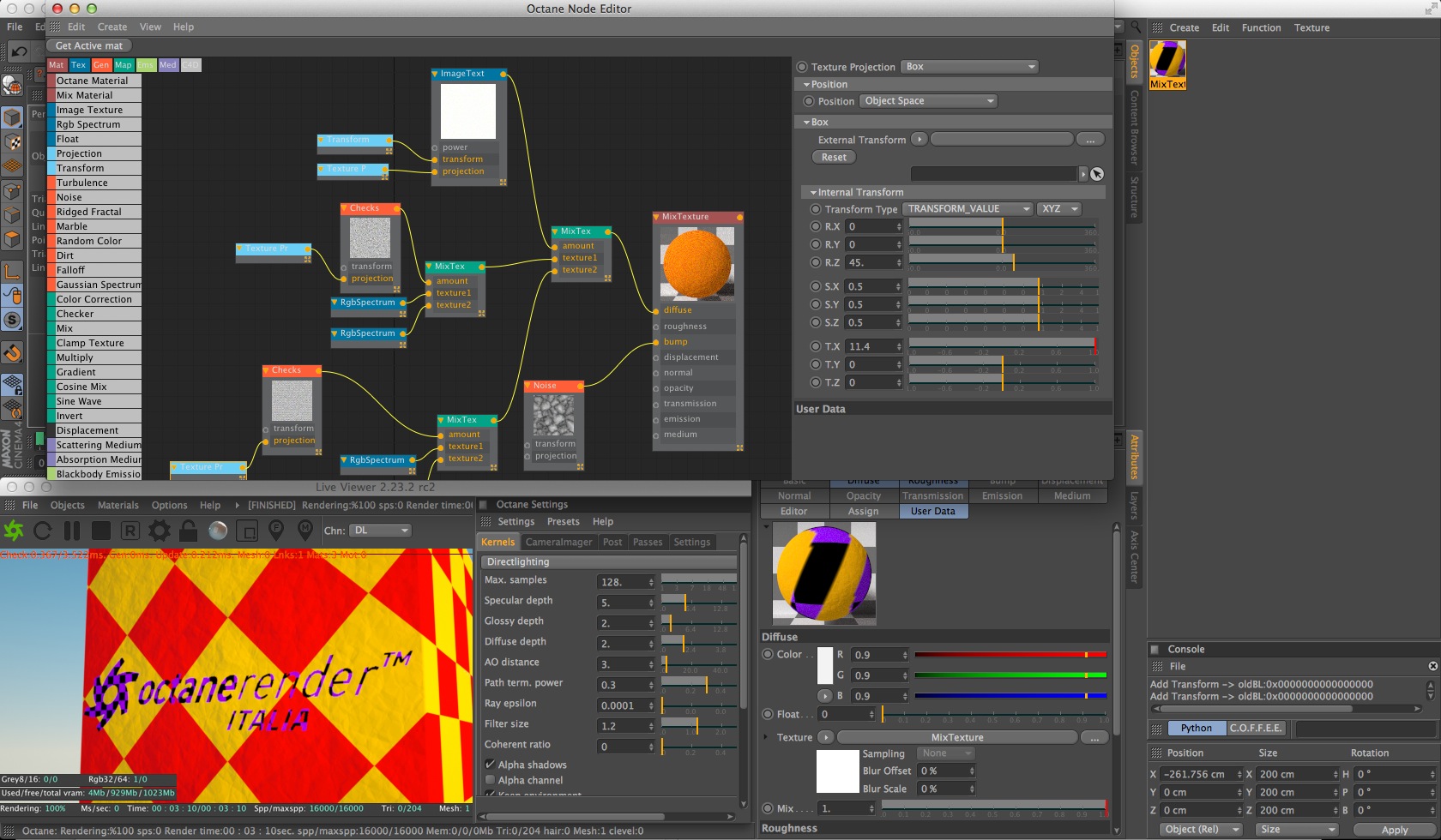

do you mean something like this?
you can use a mix material but you can use also a mix texture node inside a material and you can set different projection per any texture.

Ah I seeeee!
Yes that looks about right... I've not plaid with a node based setup yet... kind of seems to me like it should be possible with less of a setup than that though... ie - two tags one alpha - end of!
well at least its possible! :D
