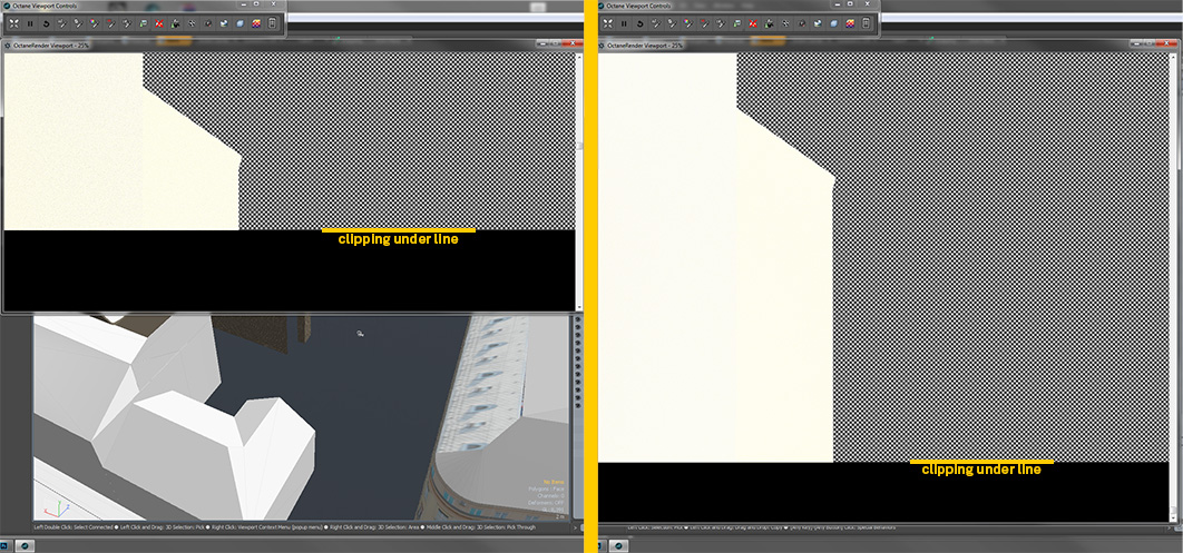

I'm making a photo interpolation of an object. It's rendering at 3168x4752 resolution (to match the photo size), however the image gets clipped at the bottom in the Octane viewport (about 20% of the vertical size).
Everything saves out fine, so it's not really a problem, but just wanted to report it...

studio3lhd
Posts: 24
Joined: Thu Oct 10, 2013 1:19 pm
I got it now, it has something to do with the current system display resolution. If the viewport is "full screen" (screen border to screen border vertically), then it doesn't clip (or clips just a little bit, my desktop is 1920x1080), however try making the viewport smaller vertically and you should see a black border appearing, clipping the lower part of the image (you can still scroll down, but there's nothing there).
You should be able to replicate the issue this way, I think.
Jan

studio3lhd
Posts: 24
Ok, here's proof, hopefully I haven't gone mad.. I've hidden pretty much everything (since I can't show it) so scene complexity is surely not the issue here.
When I resize it downwards it gets better, but it's still far off from showing the entire image @25% zoom.
The Titans are not SLI. Gaming during office hours is, sadly, not allowed! :D
Could be 801 sp4 specific or sth... With 901 coming tomorrow, I'm gonna call it solved.. :)
