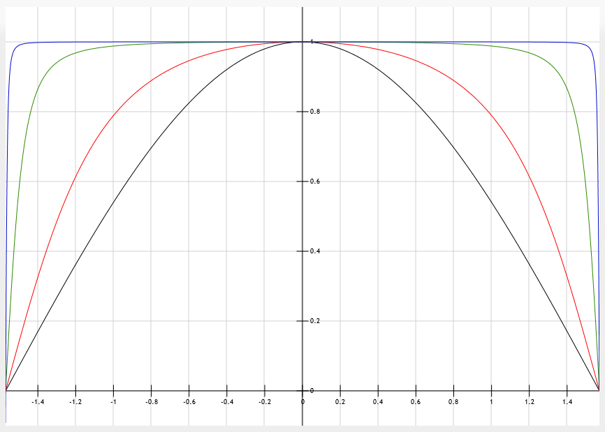

The default settings has been changed to 1 in 2.23, which minimizes the eye strain looking at the poles. The disadvantage is that even plane surfaces (like a floor) are appearing a lot more curved than with an eye distance falloff of 0.3, which on the other hand causes some eye strain looking at the poles.
This would be the eye distance falloff (from lat -90 .. +90) of 1 (black), 0.5 (red), 0.1 (green), 0.01 (blue):

The actual distance is the same of course, but the perceived is gets larger, because the distance between the eyes becomes smaller and with that the parallax effect.
