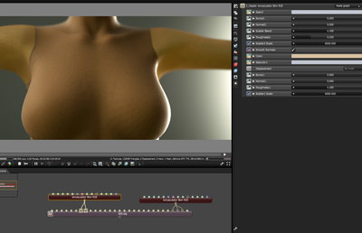

I've found that I had to set the scatter scales to 6.000 both to get a soft skintone if I export the OBJ from within Poser and import into Octane both in meters.
To avoid the issues with the mesh (as you can see in attached screenshot No.1) you'll have to set the subdivison level for the obj in Octane to 1.0.

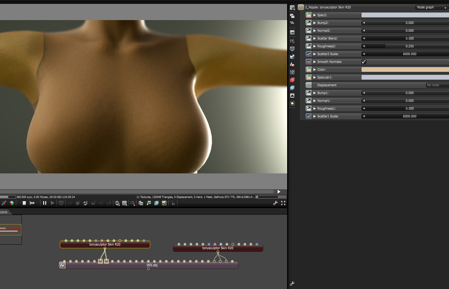

You can see the result (scattering at 6.000, texture plugged to the colour-node in R20), subdivision on 1.0 on the 2nd screenshot.
But it's STILL looking like silicone. Why?

Sreenshot No.1. You can see the structure of the mesh here.
scattering on 6.000 both. subdivision level = 1.0
