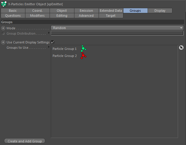

I am not able to get Octane to render Sprites that are in X-Particle Groups. They render fine without Groups, but I need to Groups to get Sprite variations.
My setup:

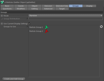

I have an Emitter distributing particles randomly to two groups:

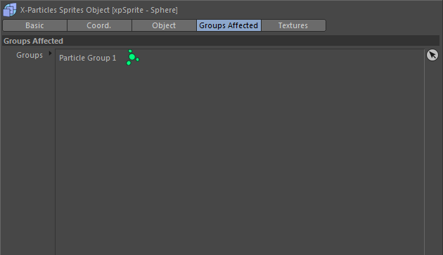

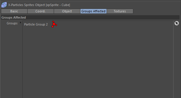

and two Sprites Objects creating geometry for the two Particle Groups

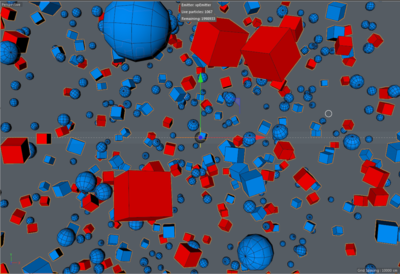

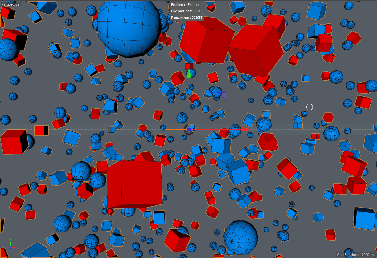

This is what they look like in the Viewport.

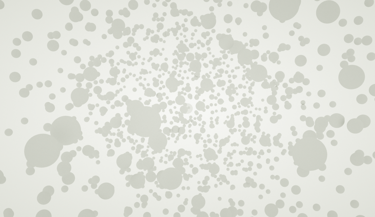

When I render, I can't see anything. I have tried caching the geometry, but it doesn't work.
When I turn on 'Enable Particle Engine' I can see my particles, but not the different sprites
Any ideas on how to get my Sprite Objects to render with Groups? Thank you.
** NOTE: The Groups DO render in the Viewport and the Picture Viewer with Octane Renderer, but not Octane's Live Viewer **
