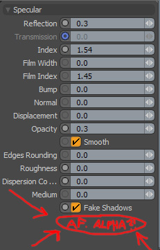

The "affect alpha" is pretty important, but it simply doesn't exist in the Modo plugin?!
It's in the version I am using (2.22.2.68).

I try to keep us up-to-date on the plugins, and I believe we're currently in the 2.22ish. Is there somewhere I can check the exact build number/version of the plugin? The about section isn't very helpful.
I have been posting build notes at the top post at http://render.otoy.com/forum/viewtopic.php?f=34&t=42581 (although it doesn't go back far). My own notes indicate Effect Alpha was added in 2.20.0.49. If you are on a later version and it is not there, delete your Modo801.cfg.

The plugin was surely later than 2.21, since its been installed for only about two weeks now.
However, I've done exactly as you've instructed and the "affect alpha" is now present in the specular material! Thanks a ton!
