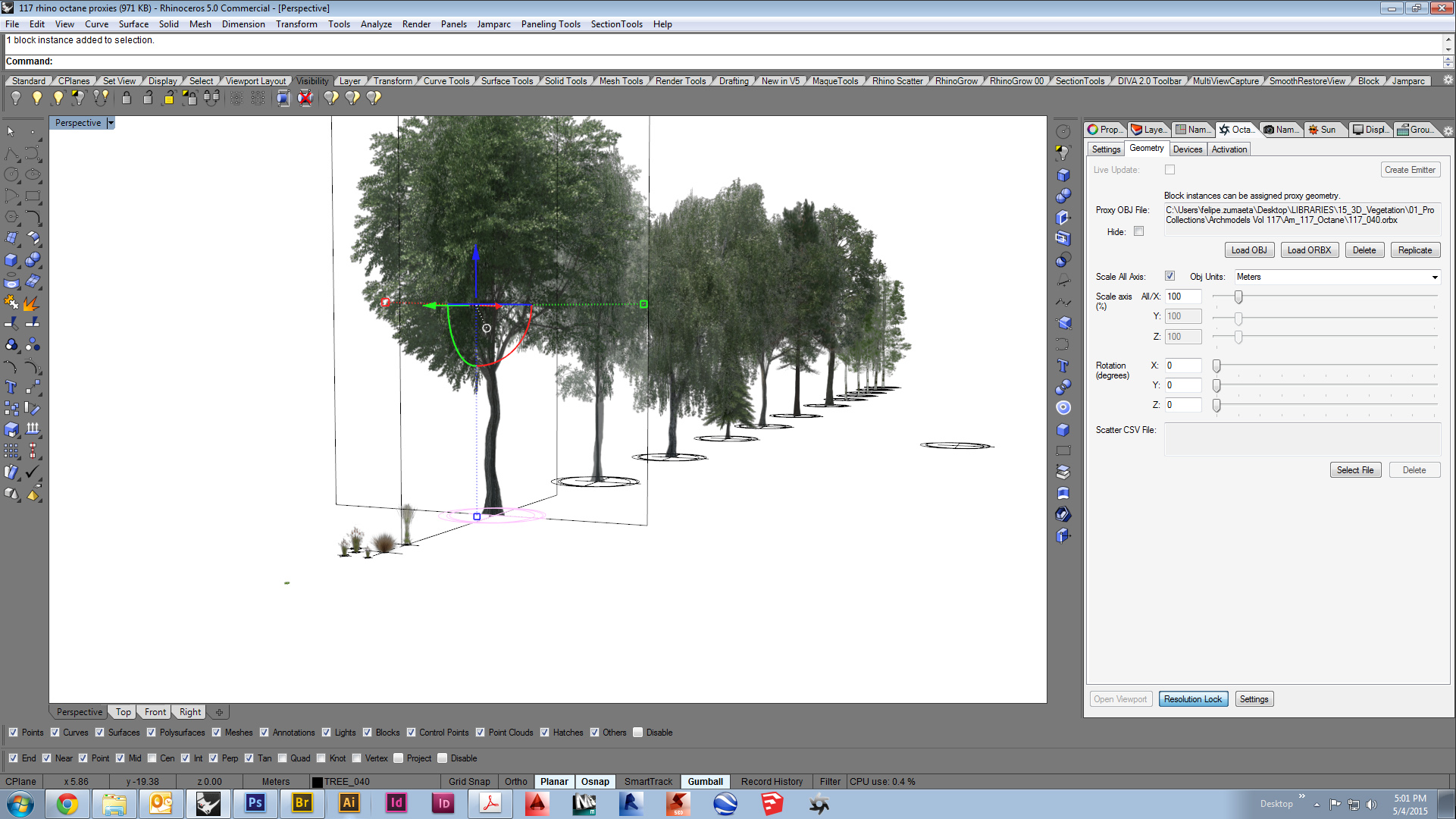

Hi Paul,
Seems that the latest version broke the ORBX instances links. I had to manually re link all the instances to make them to work and it will loose the links every time that I close the file.

I have refreshed the installers at the top of this thread with:
2.23.1.37
- Fixed error loading scenes containing ORBX/OCS proxies
- Changed Viewport navigation to spin rather than orbit
Paul
