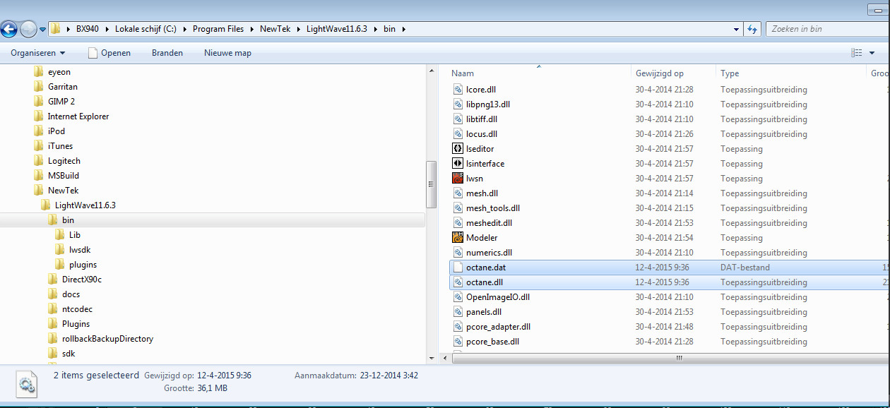

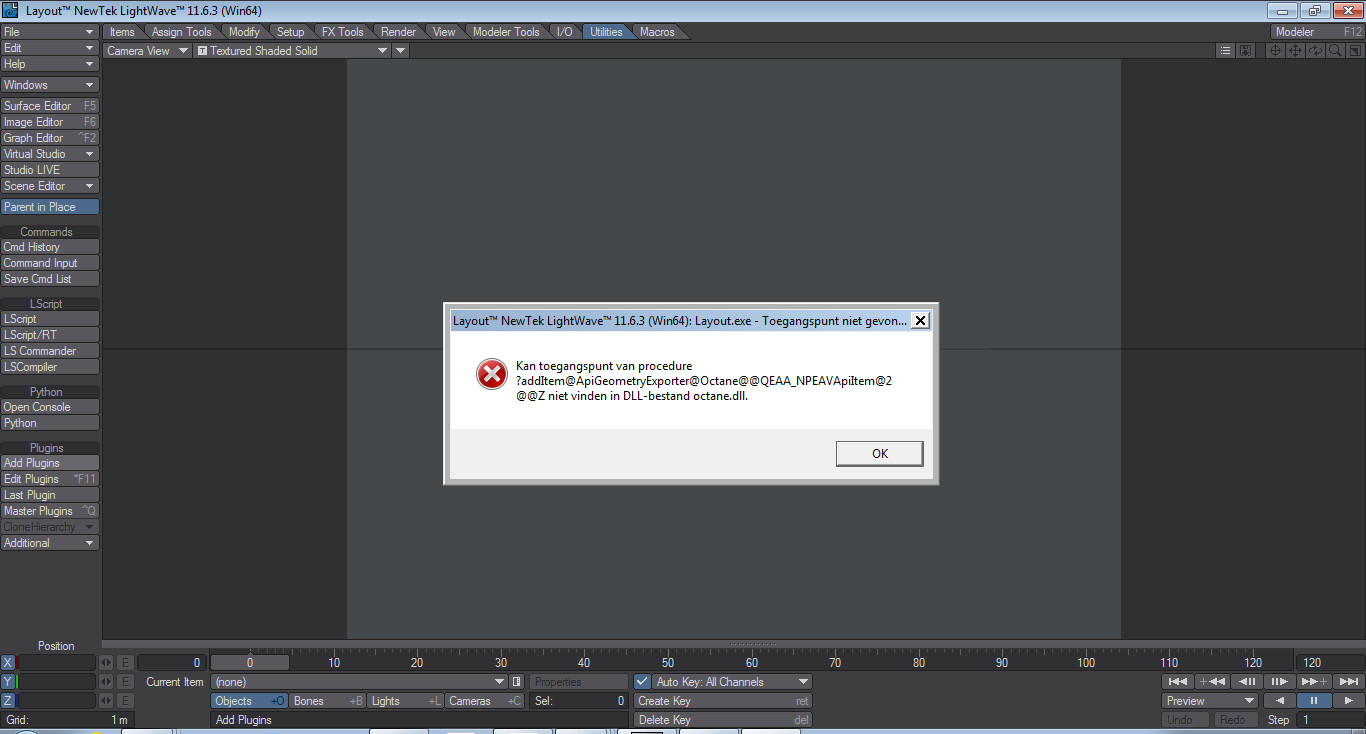

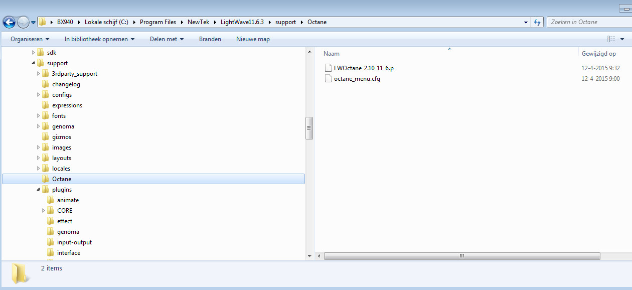

I have a problem reinstalling octane 2.2 update. As you mentioned on the Lightwave forum when I was asking about the uv map I updated the plugin. I now can't reinstall the plugin. As you can see in the attachment screenshots, I've done everything correctly. I've removed the plugin. Apparently the plugin can't find the dll file. I'm on Windows 7 64 bit.

At some point you are mixing wrong versions of the plugin .p file and the Octane .dll/.dat files.
Please, search this files in your hard disk to be sure that you don't have them duplicated in other folders and remove them. You need to be sure that the plugin .p file and the Octane .dll files are from the same .zip plugin file.

I've got the problem solved but I had to load the Windows XP version of the plugin instead of the normal 64bit version
in order to get it to work.
The file in C:\Users\Administrator\Downloads\Octane-for-LW_2.16.0_Windows\Octane-for-LW_2.16.0_Windows\plugins_x64\plugin_LW11.6 doesn't seem to work on Windows 7 pro 64bit. When I install that version of the plugin. Lightwave tells me it couldn't find the plugin.
The windows XP version of the plugin does seem to work when I install it.
Weird, I don't have more reports about this kind of problems in the 2.16 build. Anyway if the XP version works you can use it without problems, it has the same features and performance.

I probably did something wrong and mixed up some files as you mentioned earlier. Juanjon one more question. Could you please do video tutorial on your Vimeo channel on
