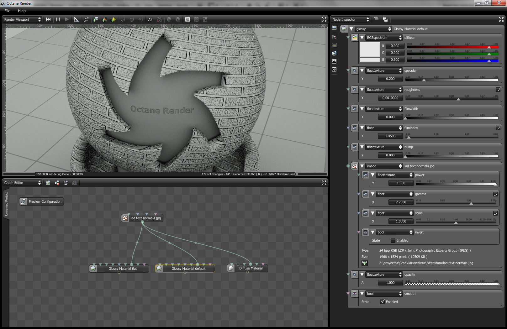

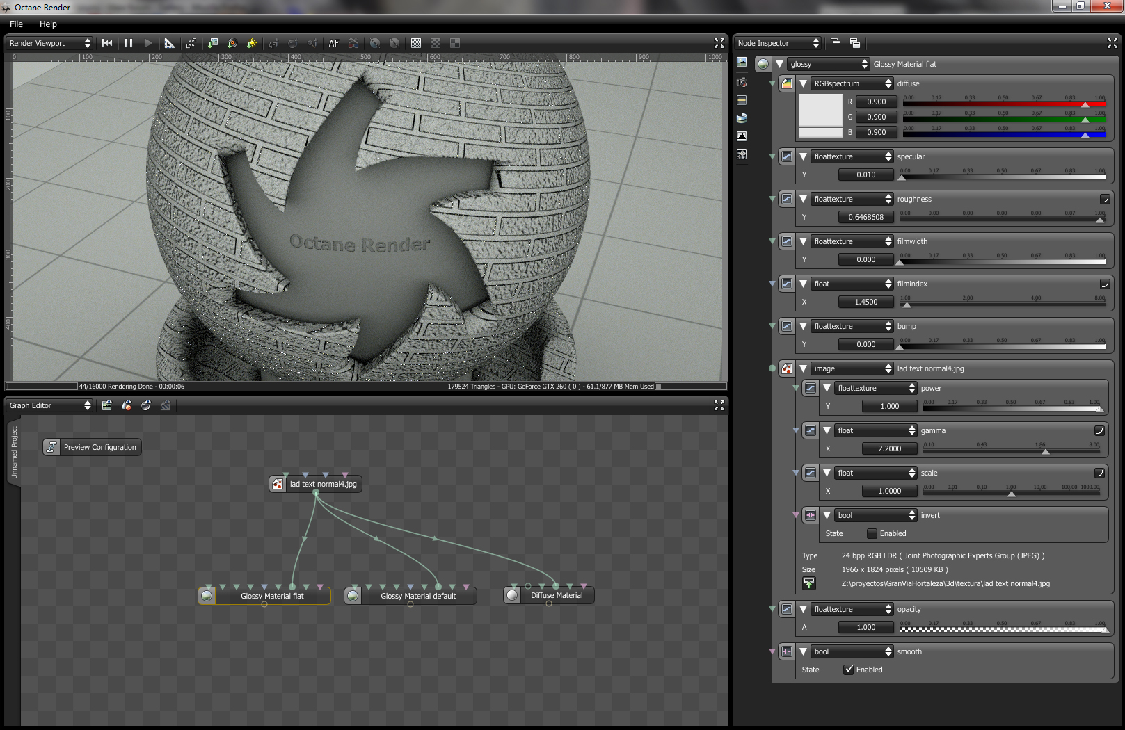

Ok, I did some test, I've also noticed that normal bump on a diffuse material is "lower" than in a glossy one, so I've done some test with a normal map I've done.
I thought that It might have something to do with glossy materials being more reflective and thus being more noticeable the bump, so I tested it with a glossy almost flat material (I know it is not the same as a diffuse as Radiance has explained a few times)
Also as you can see the normal map is giving fireflies because its value it's too high (1) but if I lower its value, fireflies do go away, but the bump in the diffuse material go away also.
