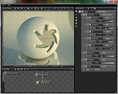

Here is a quick test I did for a bump map on a diffuse material.
To get the best results you will need to experiment with the brightness and contrast of your bump map, the right settings can make a big difference.
Another tip is to use a glossy material with low specular and high roughness instead of diffuse, the extra highlights help to add depth to the bump.

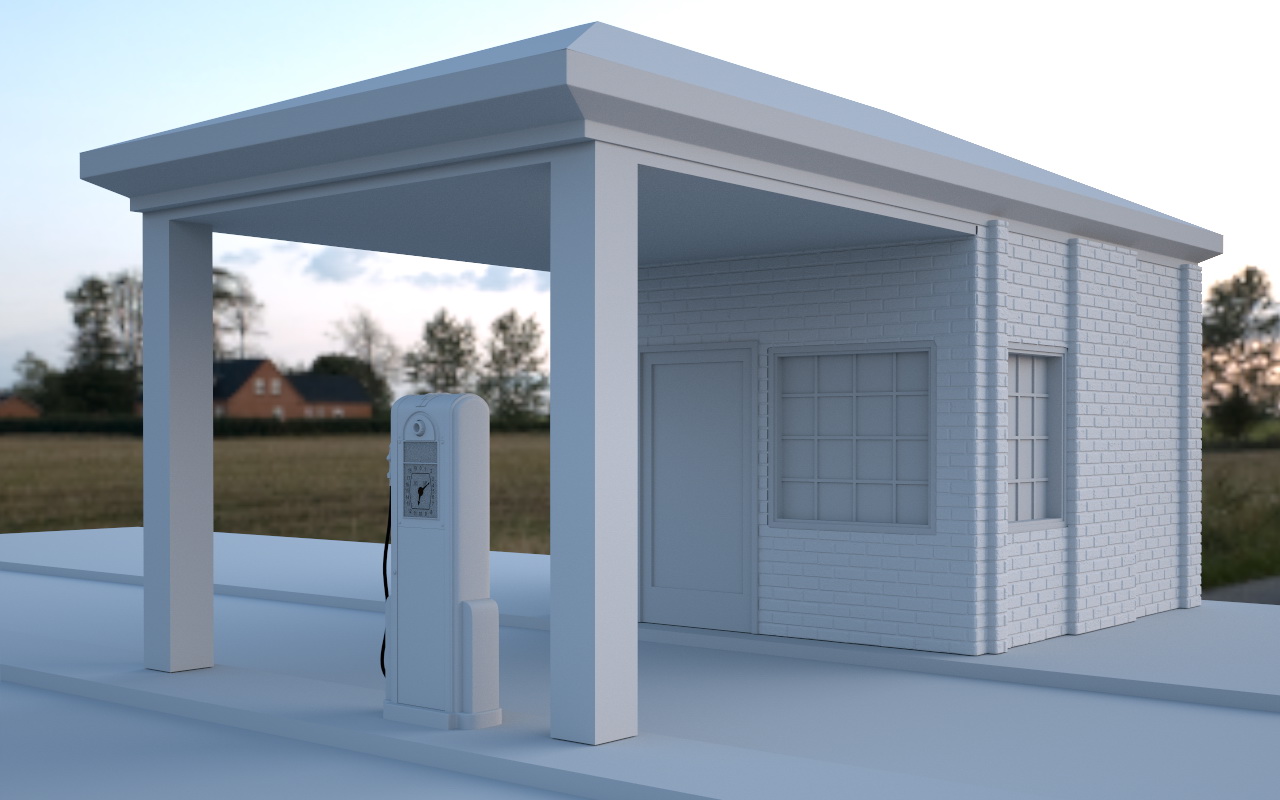

I would also suggest baking displacement for bricks if you can fit it in your video RAM. Here's my test on that subject.
