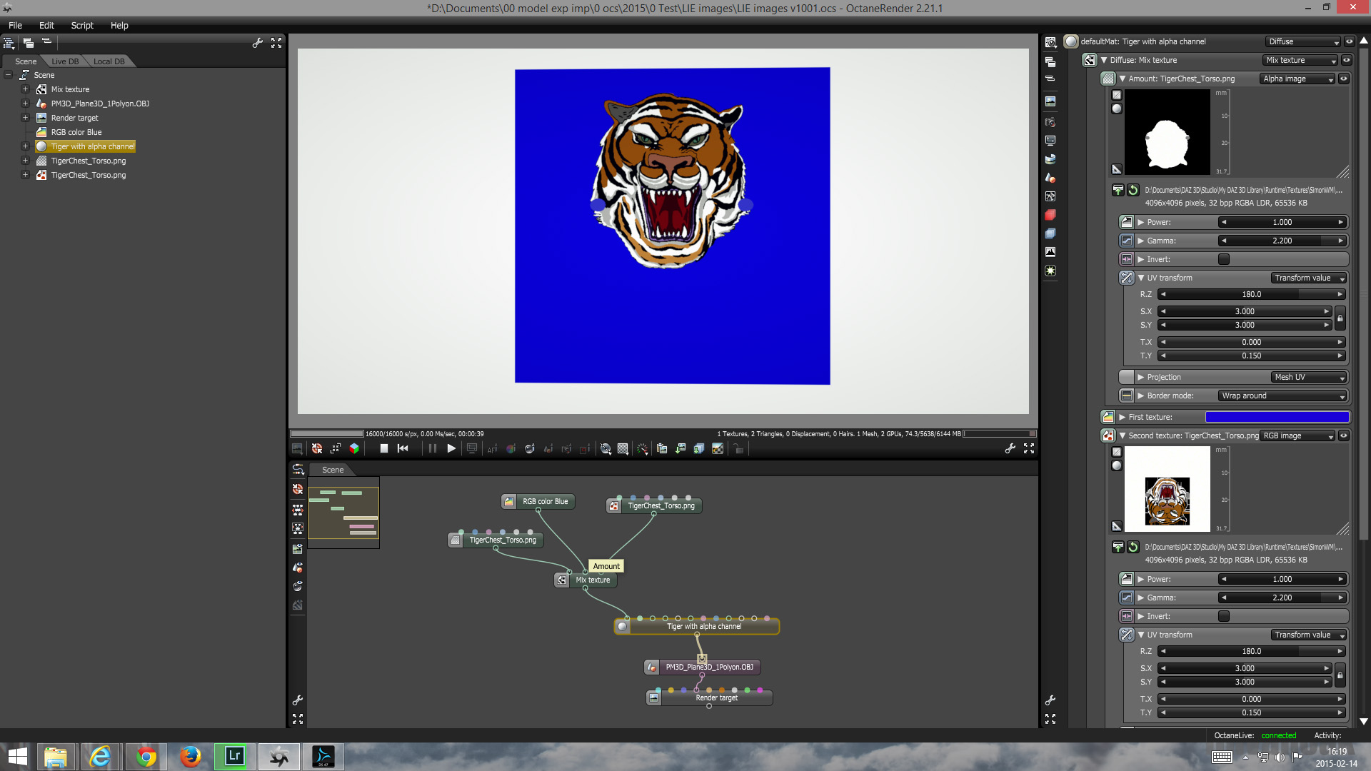

You can combine any two image and color nodes with the "Mix Texture" node.
- In the amount input pin you either plug an RGBA image with an alpha layer or a bw grayscale mask image.
Mix Texture - OR standalone
Example:
2d plane primitive with
- Tiger.png with an alpha layer.
- Blue RGB color node
Note:
The "Mix Texture" node is not the same as the "Mix Material" node. :!:

Works! Thanks mate.
