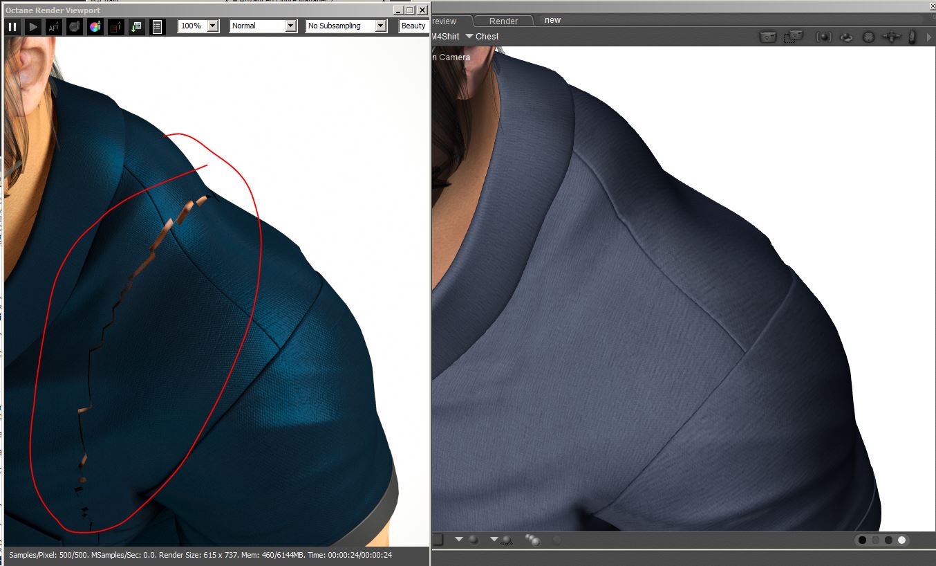

Paul, any chance you can add either a checkbox in the configuration window or have a python script turn off/on Poser Unimesh skinning method for the _entire_ scene to prevent mesh tearing?

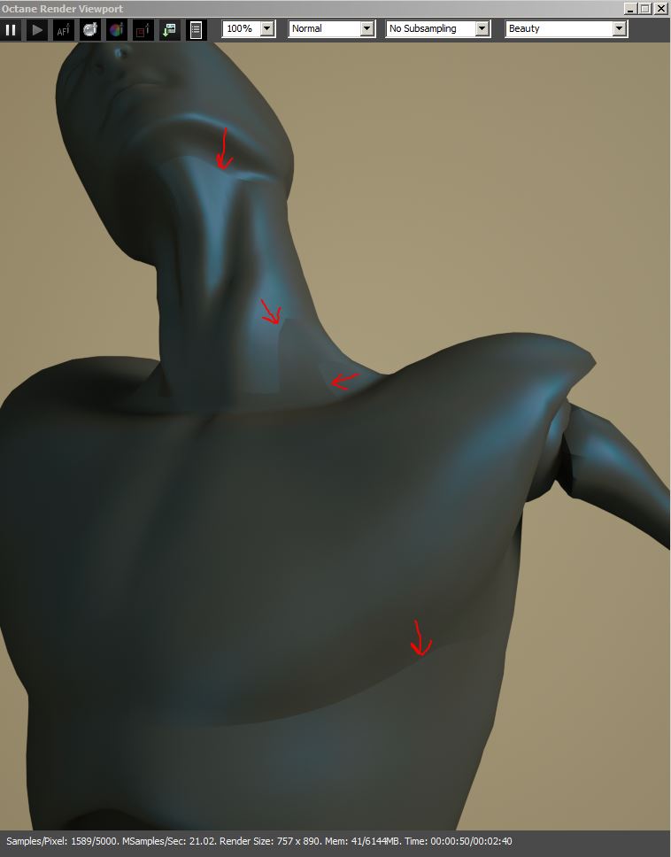

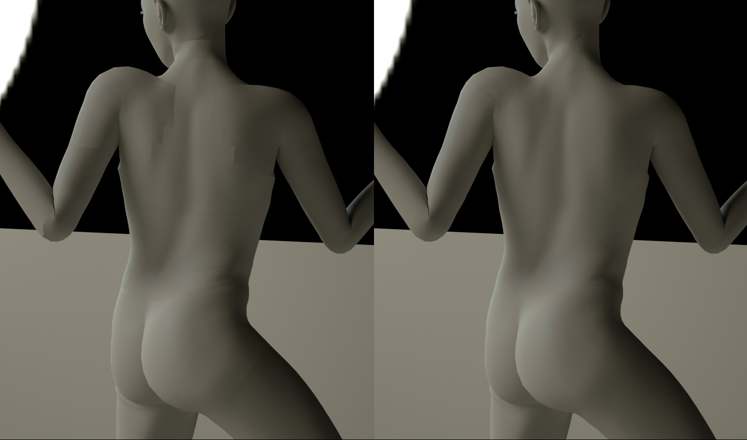

The tearing comes and goes. I don't know how to reproduce it. But the welding of the body parts with no smoothing I can reproduce all the time. First image is with traditional skinning method. Second with Unimesh.

Zay - not sure what you mean by this. How are you welding? Which Smoothing are you turning off?But the welding of the body parts with no smoothing I can reproduce all the time.

I'm sorry Zay - I am quite confused now. Did the scene you sent me demonstrate that? I opened the scene and rendered the animation and it was fine. But that was a different camera angle to the images you posted above. Did you send me the correct scene?I'm not welding anything. Poser is. But there is no smoothing between the seams.

Do you see the problem Paul or is it only me? Well, I know it's not only happening to me as I have seen finished images posted in galleries where the artists haven't noticed this problem either.
Here is Andy. See the seams from the body parts?

Thanks Zay. I have submitted a bug report to Smith Micro on the Traditional Skinning issue. I'm pretty sure that issue and the mesh tearing issue are different - but still worth getting it sorted out.
