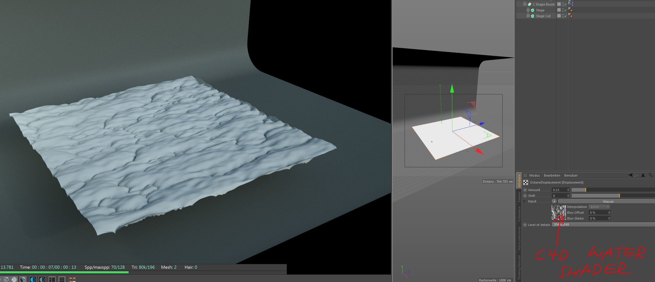

why limited to images?
Here I use a simple C4D water shader.
C4D noise works as well.
regards
Mike

miohn wrote:why limited to images?
regards
Mike
Octane converts C4D shaders into image textures
