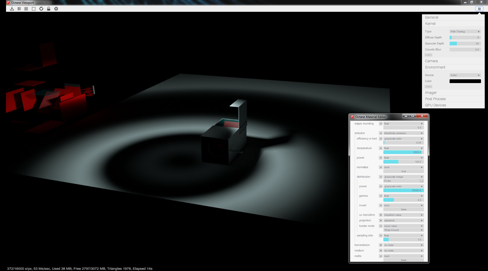

Hi!!
it´s working here in 2014 and 2015...in distribution node add a grayscale image texture, select the ies file....rotate in UV transform.

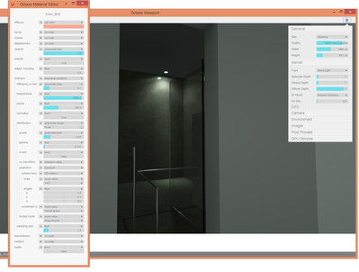

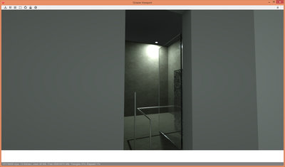

I've tried the various settings and it seems to work,
a problem occurs when I save the file, close sketchup and re open the file: the renderer doesn't show the IES emission of the light source, as the material editor continues to show the parameters saved (blackbody emission, IES distribution,power, gamma, and all projection modifier) :roll:
I use octane Version: 0.13.82 in skp v14
mac
new file (lights are correct)
saved, closed, reopened and rendered file (no IES "appearance")
