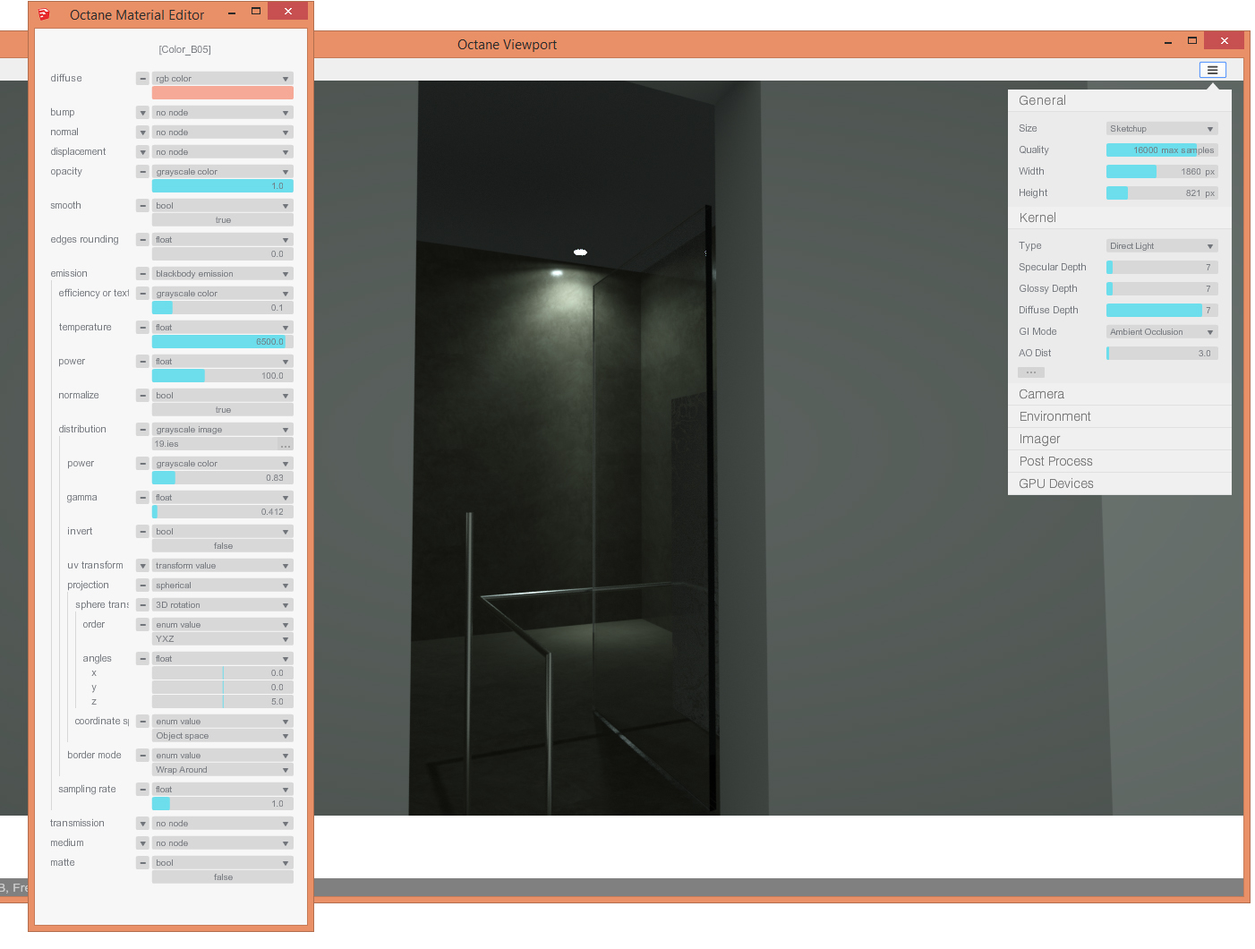

Hi!!
it´s working here in 2014 and 2015...in distribution node add a grayscale image texture, select the ies file....rotate in UV transform.

Postby macchiorlatti » Wed Mar 25, 2015 9:30 am
macchiorlatti Wed Mar 25, 2015 9:30 am
thank you perro_abombao for the reply,
I've tried the various settings and it seems to work,
a problem occurs when I save the file, close sketchup and re open the file: the renderer doesn't show the IES emission of the light source, as the material editor continues to show the parameters saved (blackbody emission, IES distribution,power, gamma, and all projection modifier) :roll:
I use octane Version: 0.13.82 in skp v14
mac
new file (lights are correct)

Postby resmas » Thu Mar 26, 2015 12:06 pm
resmas Thu Mar 26, 2015 12:06 pm
macchiorlatti wrote:thank you for the useless answer
hey macchiorlatti if you cant read a post that is trying to help, I guess you better don't ask.
this is a forum where we try to help...not a school or a kindergarten
Your question was....
macchiorlatti wrote:How can I add IES light?
thanks
mac
(...and eliminate white pixels in metal material reflections in a interior render with lights?)
the usefull answer was correct, and Smicha even helped you with the Fireflies problem.
smicha wrote:https://www.youtube.com/watch?v=Tedj2lEKvuE
and use gi clamp to reduce noise (in PT mode)
after that I just said that the workflow/technic is the same in Octane StandAlone and inside the plugin, because its the same program.
Well if it works or not is another question.
It actually works, but with a small bug.
To set the ies light to work you need to create a material in SU, with a texture applied, Ex: Light_ies1 with texture A("use a image texture" option in SU material editor), then you convert to Diffuse material in Octane material editor. Then you select the IES you want to distribution and all will work after closing and reopen the program.
