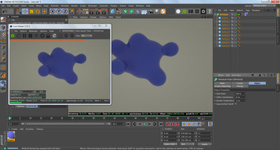

I've had this problem since yesterday, where I can't use the metaball and get it to show up in either the liveviewer or render. I've attached a screenshot of the file.

Edit: forgot to post the screenshot. Duh! https://www.dropbox.com/s/mlc6tovm6o6gc ... 7.png?dl=0
