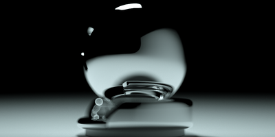

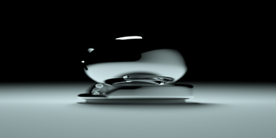

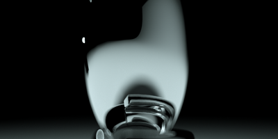

Is that what you want?
Pixel aspect 1:1:
Pixel aspect 2:1:
Pixel aspect 1:2:

abstrax
Posts: 5510
If you look at the images, it does exactly that: Squash/stretch the DOF disc. So my question again: Is what you see above, that what you would expect?

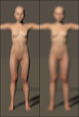

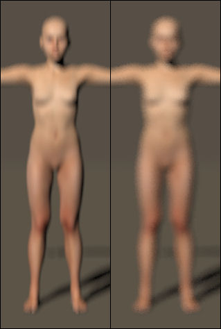

Here is an example I did in Poser (see the attatched file), I did it using the same technique I pointed out in my previous post.
On the left is Anamorphic bokeh rendering, and on the right is standard bokeh. I did it by doubling the width of the figure in the Anamorphic version and then squeezing it back again after it had rendered. The bit you need to really understand here is that although the figure was doubled in width BEFORE I rendered it, the DOF calculated by the renderer is just behaving as normal. That's why we effectively have a normal defocus effect fired at an object twice the width. This is how we seperate the bokeh aspect from the scene aspect. The key is that a normal defocus was fired at an object that was twice as wide as I required it.
Anamorphic bokeh gets more vertically stretched the more it is out of focus, and it makes perfect sense when you think about it because stretching something in one direction amplifies the effect - so if you have an amount of defocus and stretch that in one direction, it appears to grow in that direction, and the more it is out of focus, the more pronounced the effect, this is why the bokeh gets more stretched the more it is out of focus.
The attached file isn't the best of examples, but you can see that Anamorphic bokeh look much more real-world lens like and cinematic than the standard bokeh. The problem with the technique used here is that the scene objects themselves had to be stretched, and that only works in a head-on view, that's why the film plane itself needs to be able to change it's aspect so that what is captured to it will get deformed in postwork when it is squeezed back, that's what happens in the real world, that's how it works. Basically, a cinema projector has an Anamorphic lens attached to it which is used to correct the Anamorphic lens that was attached to the camera they shot the film on.
