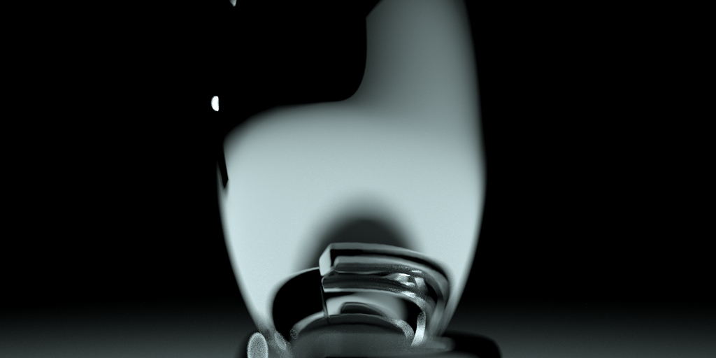

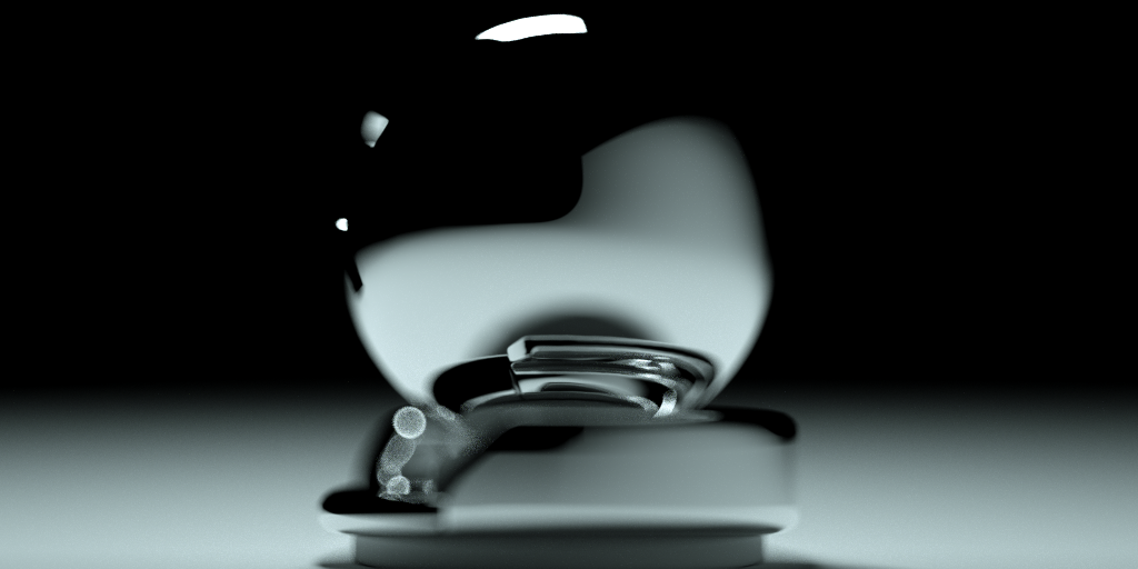

Ok, yea, he's talking about anamorphic bokeh, not pixel aspect ratio. Which is good, because not many need to output to non-square pixels anymore. But bad because it's not as quickly implemented.
Here's a good link on anamorphic lenses that RED put together: http://www.red.com/learn/red-101/anamorphic-lenses. Most all anamorphic lenses have a 2:1 squeeze, even though cinematic anamorphic comes in a few different aspect ratios.
I like the way V-Ray handles bokeh: V-Ray Physical Camera. It not only has an anamorphic control, for squeezing or stretching bokeh, but it also has iris blade count and rotation controls.
The trick is to be able to render that anamorphic "squeezed bokeh" look while still outputting to square pixels.

If you look at the images, it does exactly that: Squash/stretch the DOF disc. So my question again: Is what you see above, that what you would expect?
No, I don't think we're on the same page yet. That's pixel aspect ratio.abstrax wrote:If you look at the images, it does exactly that: Squash/stretch the DOF disc. So my question again: Is what you see above, that what you would expect?
Here's a clearer example:
Same pixel aspect ratio, but the bokeh is squeezed/stretched with the anamorphic lens vs the spherical.

No, that's not the same, but what you did there demonstrates the problem perfectly. If you look at your images, notice you were able to change the aspect ratio of the scene, but the aspect ratio of the bokeh has also been changed. The Anamorphic bokeh effect is achieved by stretching the scene back to it's normal aspect while at the same time, keeping the bokeh stretched, but in the opposite direction (horizontal bokeh becomes vertical).
