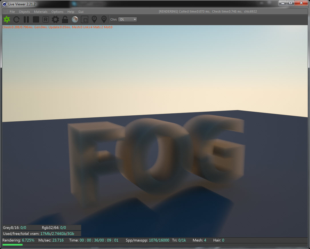

easy task. But it's very computational of course. You need some volume and specular materials. Index=1, fake shadows and scattering medium as in samples.
