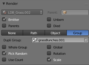

If I understand rightly, the Grass Essential is just a very good models of grass and nothing more. If so, you definitely can use it into Octane for Blender. Why not? :)

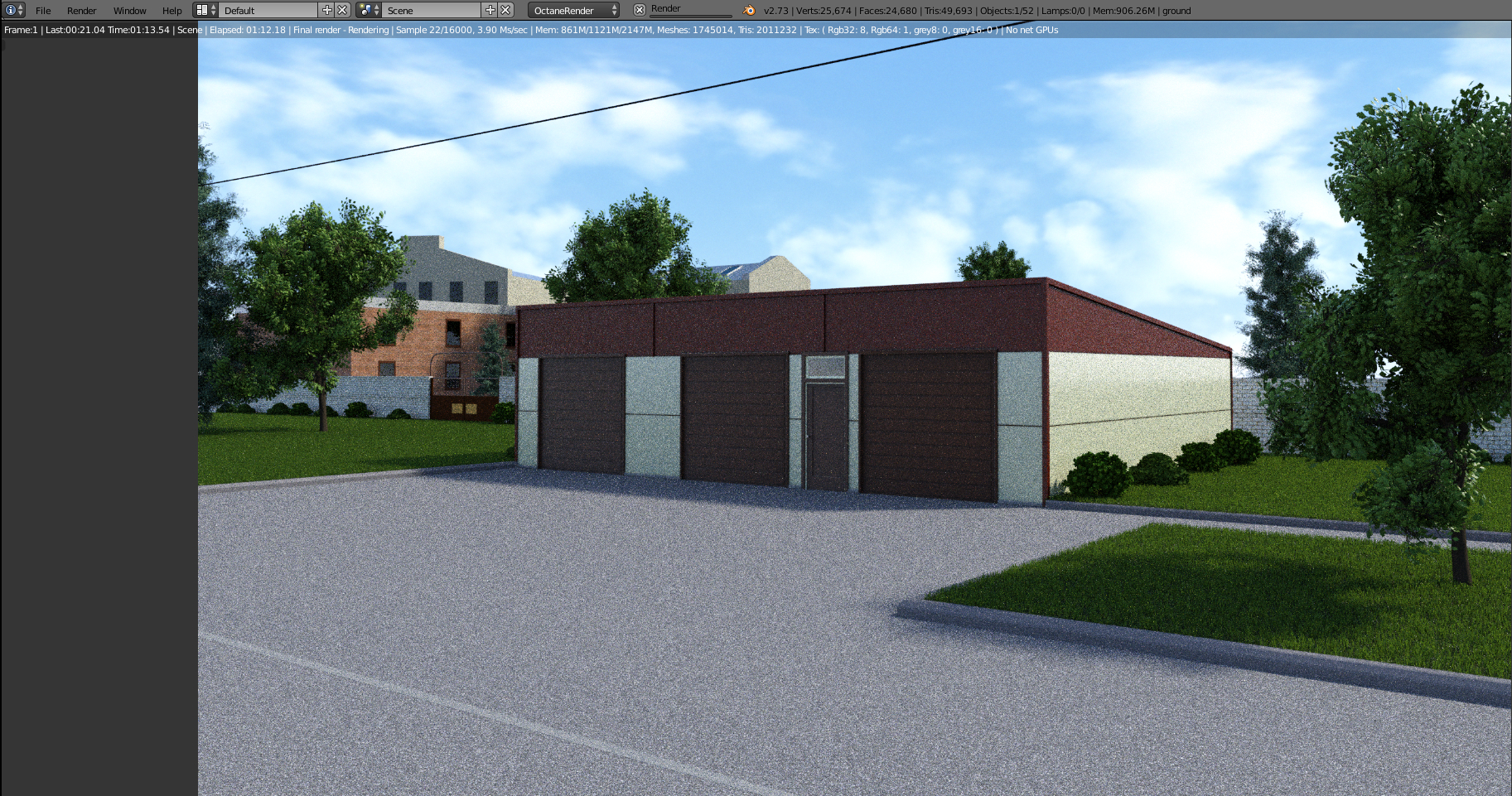

I'm not sure (actually I have a guess) why you have problems working with instances but take a look at one of my scenes. There are a lot of grass (instances emissions+children) plus trees and bushes (duplications). And it takes only 45sec before an image appears in the renderview. And I have only 2GB of GPU memory.
You can calculate it by yourself, but there're more than 1'600'000 instances in this scene without trees and bushes. For all greens I used several objects and groups of objects as a mesh-source, it's the same way as you can use the Grass Essential.
About my suggestion. First of all, check which Mesh type have you chosen. Maybe the problem is you're trying to work with instances using the mesh type Global? ;)

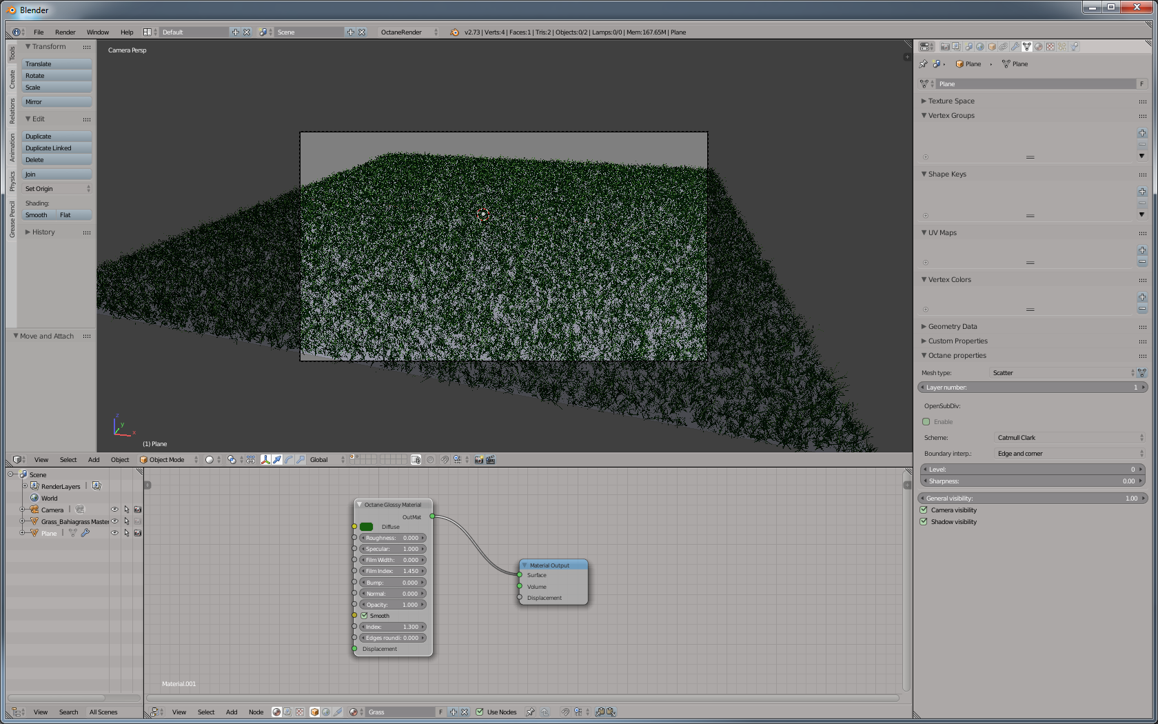

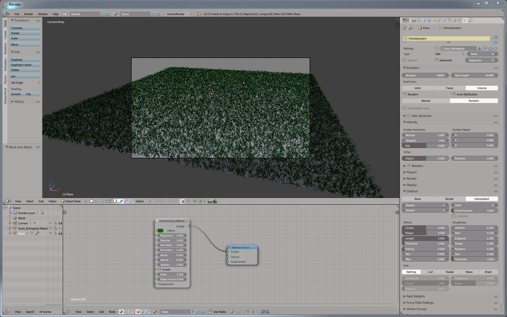

This is the problem: the material adjust/conversion
i test the sample file: https://s3.amazonaws.com/ezs3ac34a26aa3 ... rass.blend
http://www.blenderguru.com/tutorials/ma ... dow-scene/
the material node is too complex.
someone has tried?
sreenshot
sreenshot

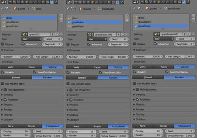

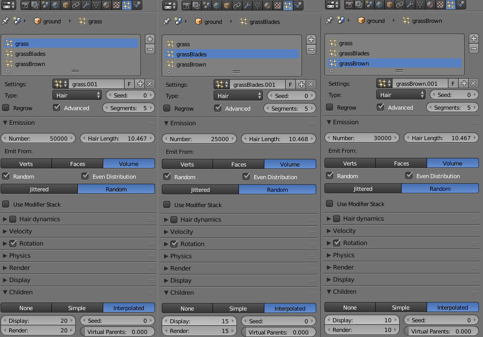

Saramary wrote:If I understand rightly, the Grass Essential is just a very good models of grass and nothing more. If so, you definitely can use it into Octane for Blender. Why not? :)
P.S. I really love Andrew Price's grass pack! It looks super realistic, a lot of hard work was put into it. It's not cheap but I think it worth it.
The attachment Grass_rendersettings.jpg is no longer available
The attachment grass_settings.jpg is no longer available
The attachment Grass_source.jpg is no longer available
The attachment Grass.jpg is no longer available

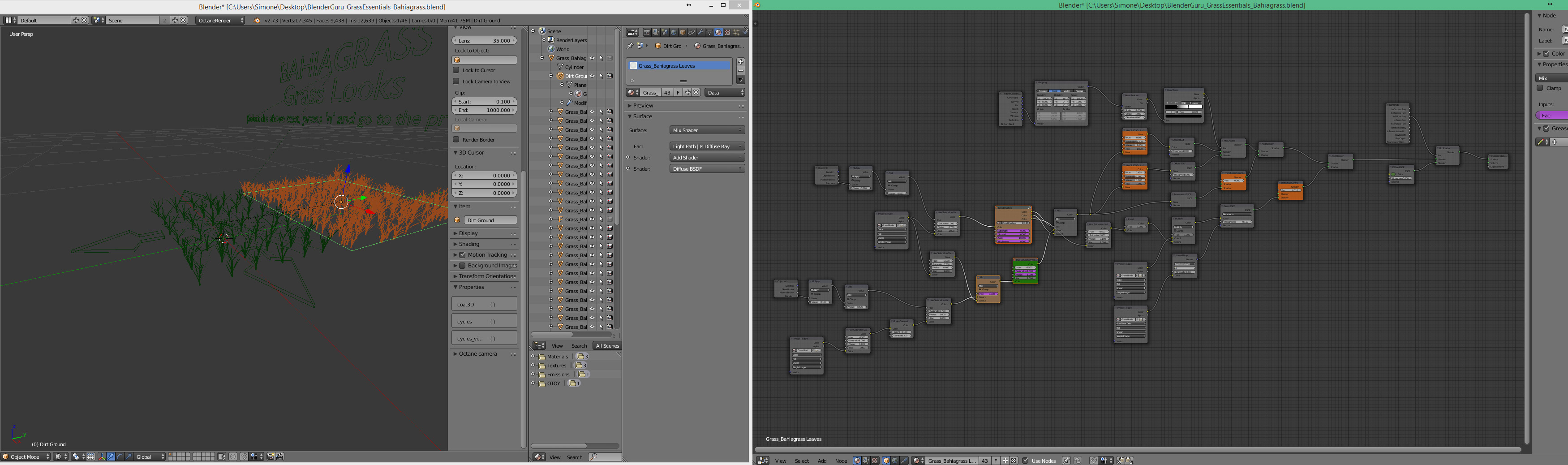

Hey Sara, I was still unable to get this to work. I waited over 10 minutes and still nothing. Very frustrating indeed. I have attached images and a blend file for you to try.

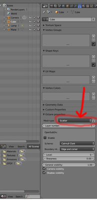

Hi Simdla and all others,
i have the same problem with octane blenderplugin and particle, only work ist to set Scatter in render panel. After 5 sec. is started the rendere.
But if activate other Objects become error...
The way to set scatter to the plane in objekt data -> Octane properties and in the render panel to "As is" dont work. i wait over 30 min... only TRANSFERING...
shit :-(
best regards Stefan

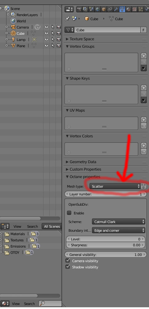

hi planung-klein ,
the object to be repeated is of scatter?
