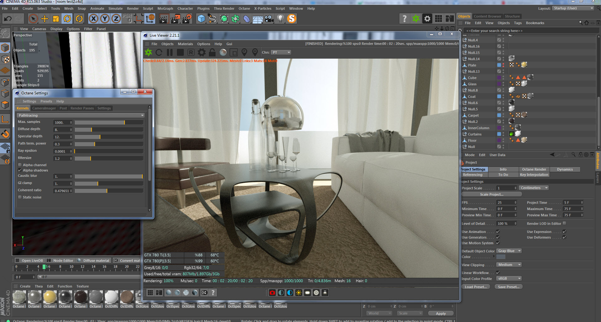

im use Path tracing just with 1000 sample . Why it so hard , my pc is very delay , so slow
This is my pc
Chip: Xeon e3-1231v3
Ram 16GB
VGA : GTX690
SSD:128 GB
Main:ASRock Fatal1ty H97
GTX 690 is not good for octane render ?
pls help

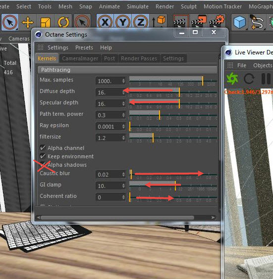

tks so much aoktar . It is better . But it still delay 5-8saoktar wrote:activate render priority in Settings->Gpu tab. Click gpu checkbox and select low or middle.
But i think your render is going very slow. 0.1ms/sec is very very low. Try to decrease diffuse depth, etc... This scene is from our comparison for Corona, can't remember our speeds. But i draw the directions in image, these will give more speed for you.
Edited a little bit the scene to make it faster. There is some changes on kernel settings, also on a few objects and their materials. Coherent ratio, gi_clamp and diffuse depth is most helpers.huyrua811 wrote:help me pls
