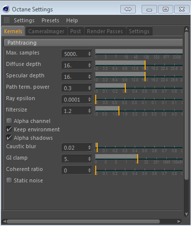

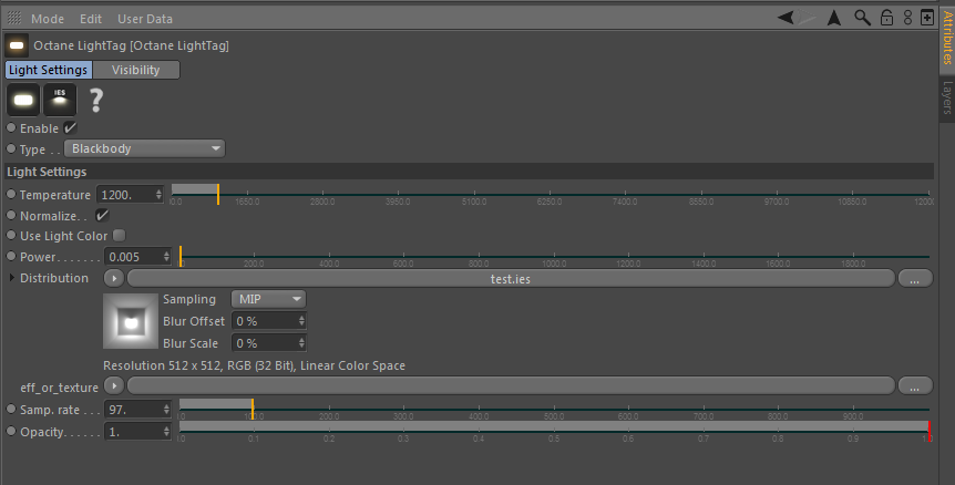

eyeonestudio wrote:Real World Light Have Very Complex Falloff. Default Area Light is Not.
If you want Real Light Simulation... You Need that LED "ies" Data File.
You can use with octane ies light.
The attachment ie.jpg is no longer available
DL4 use Pathtracing Kernel
Firefly --> Reduce GI-Clamp Value
Glow --> Use Post Processing : Bloom Power
The attachment DL4.zip is no longer available
If you want volume light... do not use pmc. very painful. :oops:
serch this forum. keyword "volume light". :roll:

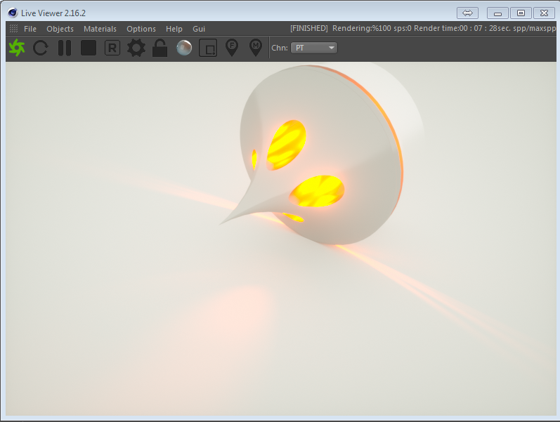

Very nice work, thank you! I rendered the scene and this is how it came out. I put in the ies file and rendered in PT not sure why it is so much lighter than yours?

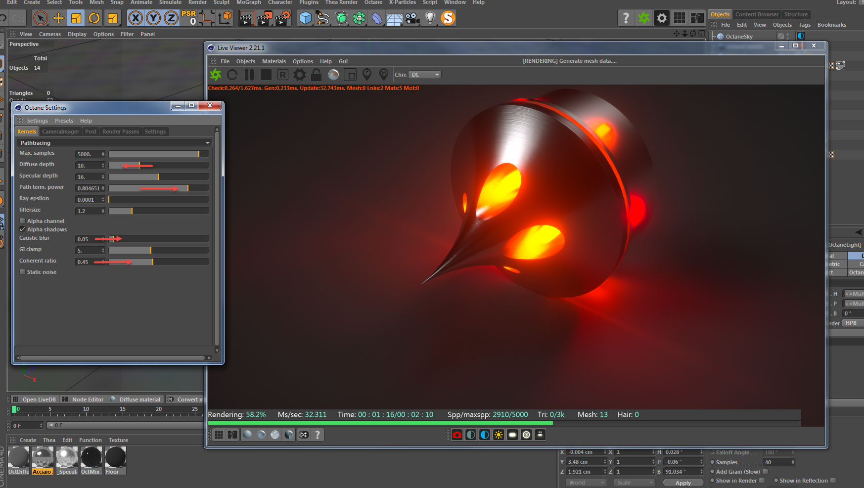

He is using black environment color.
Another fake try here. Propably your modelling/setup does not match the real model. Somethings is blocking the lights to reach to out.
DL5.rar
(1.55 MiB) Downloaded 421 times

aoktar wrote:He is using black environment color.
Another beauty, love the metal texture, thank you for the scene redo aoktar!
BTW you are rendering at 32.311 I am rendering at 5.7 is your signature still your current setup? We both have a titan You are getting that much more with 2 590? I have a couple 580 lying around, I may have to put them back in. The 590 were too hot with just air cooling
DL4.zip
I'm not using texture environment.
1. No texture environment. use one area light
2. setting --> Other --> default environment color (Black) :)
