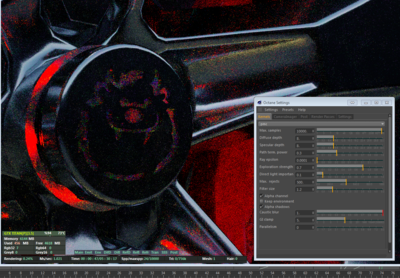

Greetings all, been reading through the posts trying to find a balance in rendering times and quality. Most of my work is done in night scenes with low level lighting so I tend to use PMC.
I have been trying to get the best out of the plug-in for C4D primarily getting Octane for the speed but am crawling through renders in PMC. It is taking 5-6 hours to render not sure why. I am attaching my render settings and wonder if anyone has suggestions that might help.

This picture is at 98 % finished and 6 hours

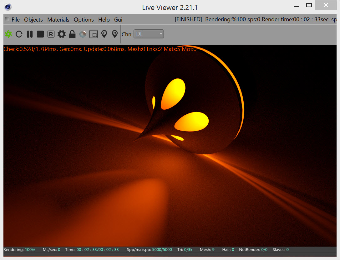

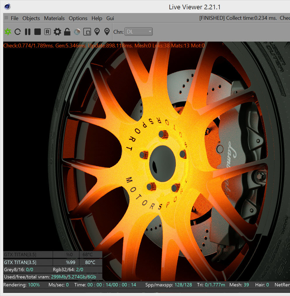

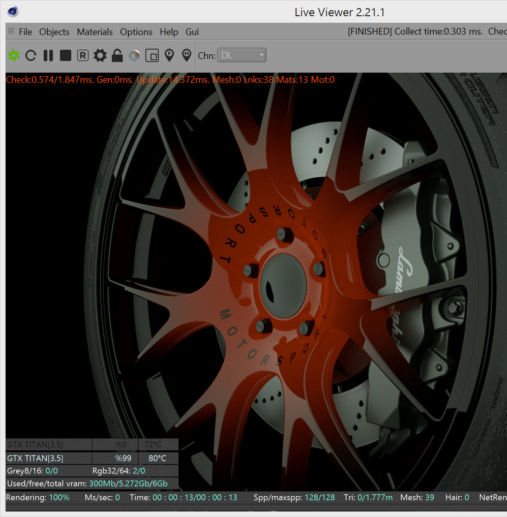

Ok.... inside LED
Look... I make simple scene. Upload for You. Point is Mix Material.
DL1 Scene is Texture Emission Here is you want. DL2 is BlackBody Emission

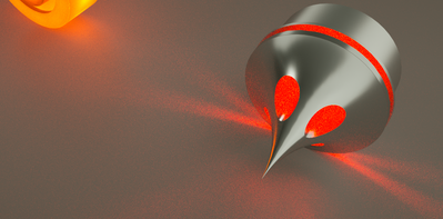

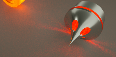

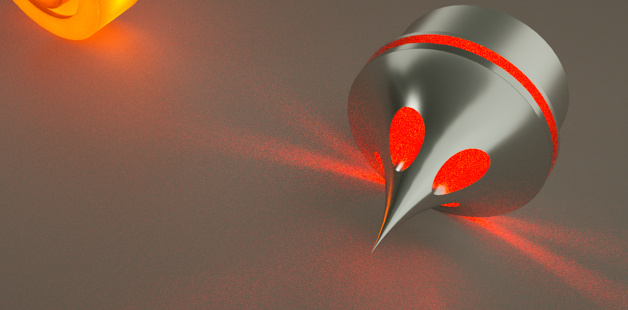

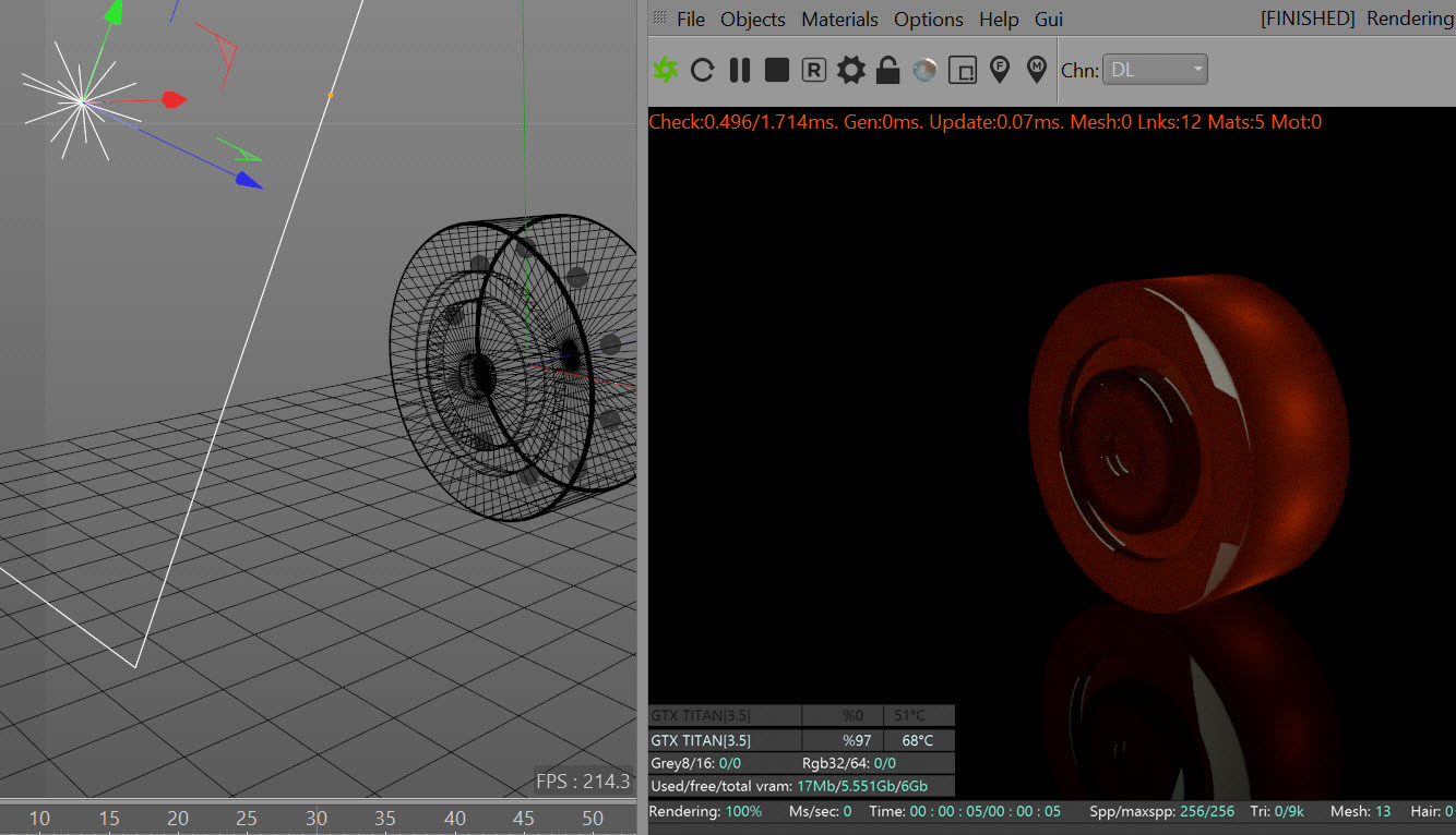

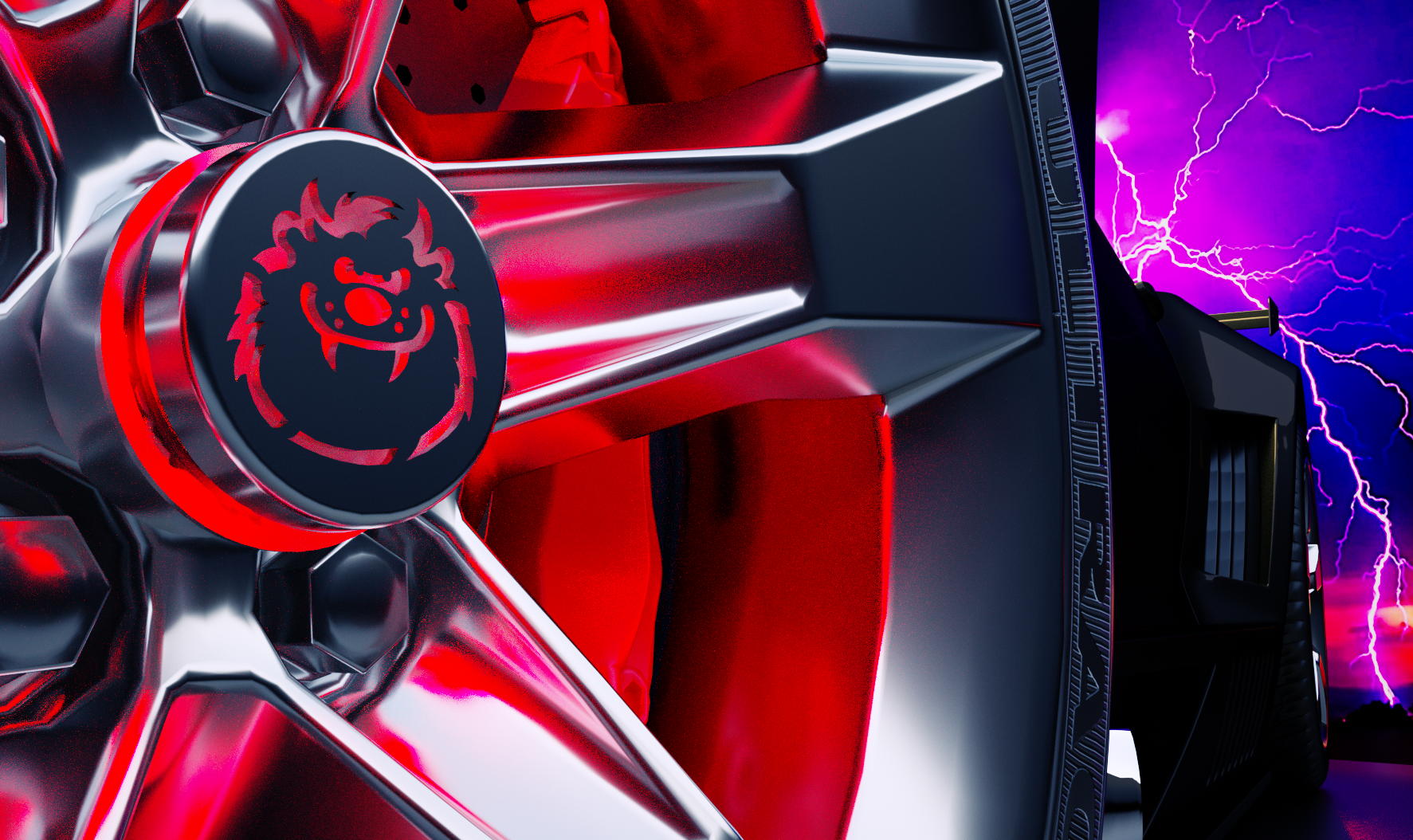

eyeonestudio - making a texture emission can emulate the lighting very well, and the render times excellent. however I am trying to capture the effect of the light as it spreads across the surface including object reflections.
e.g. The 1st pic below is a real photo. The light is flowing everywhere and bouncing off of objects.
If I were to use your scene and to to re-create a 3d model and render at your settings in PT I can get the render below.

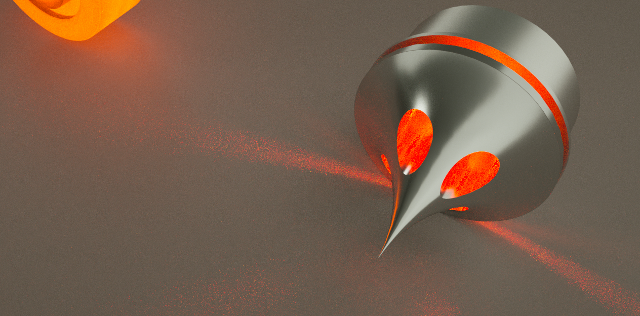

If I use PMC at 1000 samples I I can get the render below. It is not near the photo but it is less grainy and in my opinion handle the spread of light better.
Lastly using your scene I up the PT to 1000 samples. Still not as good as PMC but render in half the time.
I am including the 3d file if you want to give it a try to get as close as you can to the photo.

Real World Light Have Very Complex Falloff. Default Area Light is Not.
If you want Real Light Simulation... You Need that LED "ies" Data File.
You can use with octane ies light.
DL4 use Pathtracing Kernel
Firefly --> Reduce GI-Clamp Value
Glow --> Use Post Processing : Bloom Power If you want volume light... do not use pmc. very painful.
serch this forum. keyword "volume light".
