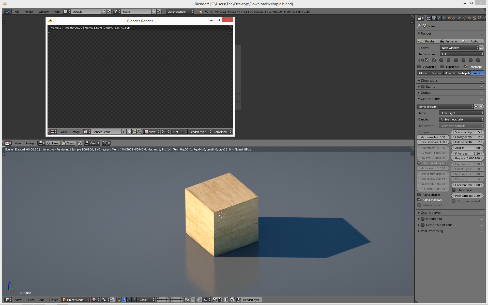

But one thing I still don't get: Is F12 supposed to give you a Blender render? (I assume that's what it is, judging by the window title -- and as you can see on the attached image it doesn't work.)
Isn't F12 supposed to give you an Octane render?

You can't render the live preview and F12 render at the same time. The render server can do only one job at the time.

Ah OK, thank you!
